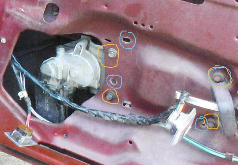

I put manual window doors on my car (better shape) but i want to keep it electric power window. I try to swap it today but the bolts pattern was not the same. I make 2 news holes in the door on the motor side to keep it in the closer position than the manual one. The window work great but around 2 inch high miss to close it properly.
I see that the mechanism was not really the same between the manual than the electric. I think i have to bolt everything higher in the door?

The power window regulator does bolt up in a slightly different position. The only mount location that remains the same is the top rear. The 3 other mount locations move down. Blue represents the original mount locations for the manual regulator and the orange represents the power window regulator. Here is a pic for reference.
Manual to electric window Manual11

Post by tropdeprojet Sat Jan 06, 2018 5:10 am
g3chevy wrote:The power window regulator does bolt up in a slightly different position. The only mount location that remains the same is the top rear. The 3 other mount locations move down. Blue represents the original mount locations for the manual regulator and the orange represents the power window regulator. Here is a pic for reference.
Thank you!
I will try this.

Post by tropdeprojet Sat Jan 06, 2018 8:18 am
Now both windows works great! They touch the up and down stopper.
Thanks Again g3chevy!
