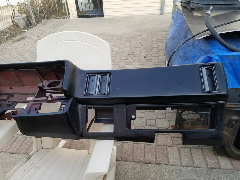

I have been shopping for a dash pad for the '76 Laguna S3 I picked up back in January, as most of us know these things deteriorate over the years and crack, mine is no exception!
I have seen and done (replaced) several over the years, but I found the generic as follows:
- there are 6 basic types:
- one piece
- two piece
- the one piece dash without the AC vent on the passenger side
- the one piece dash with AC vent on the passenger side
- the two piece dash without the AC vent on the passenger side
- the tow piece dash with AC vent on the passenger side
The only 2 other aspects that make these different relate to the emblems:
- those for '73's that have the holes for the emblem studs
- those for '74 thru '77's that have the square indention to the passenger side for the emblem.
Came across one yesterday that looks like it is one piece, has the AC vent, but NO place for the emblem?
Looks to be in pretty good shape, little issue at the speaker holes on the top.
Anyone have or ever come across a dash pad without the square indention for the emblem?

Nice Find! In all my years dealing with the 73-77 Chevrolet A Body cars, I have never seen a 74-77 dash pad without the insert on the passenger side. I just wonder, could this have been Canadian version? I always thought they were the same. You could just glue on or double tape the correct insert, or place a 1975 "type S-3" door panel emblem there by using double sided tape also. I bought an NOS one on ebay right at Christmas time, it wasn't cheap but still less than the one I had redone by "just Dashes" it was just over 1800.00 including shipping, it was nicely done but too thick. You cannot beat OEM by GM. -again, congradulations on finding one-Mitch

I was wondering if this pad might have a cover on it? I looked pretty close at the pictures and does not look like it is a cover?

It just might have a cover on it. You can do a much better and neater job putting on a dash cap if the dash is out of the car. For the one on ebay I negotiated a deal down to 1,150. I had offered 1000 but he was asking about 500 more. I bought a really good used one a few years ago for 800.00 for my 75 el camino -true SS with the (RPO 6H1) "soft face" Laguna front. these were available through COPO. I have a build sheet to prove it. There is a factory picture of one in the Chevelle 50th anniversary Hard cover book- a must have for any Chevelle/el Camino guy.

I looked at the pictures of this one and I don't see any indications of it being a cover? All the covers I have seen just don't seem to cover the lower corners very well and this one sure looks like there are no seams or anything like that, only issue is the lack of the emblem mounting spot.....It looks like is has been sprayed or dyed before, some rough spot on the top above the instrument cluster area, could be cleaned carefully and then dyed again, I need it black. The little spot/broken area in the speaker grill could be fixed pretty easily.

My money is on the dash having a cap. Unless they filled the two holes or square area where the emblem would be and re-painted it.

Dash is the same regardless of what country it was originally from....The one displayed is either a 73 with filled holes or a repaired 74-77...

I got the guy to send me a pic of the back, you can the 3 holes for the insignia that have been filled in, so it is a '73, other than that looks pretty solid? I am passing on the dash pad, want a '74-'77 so I can put my Laguna insigna on it.
