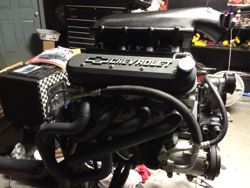

Post by NOMOREWORK Sat Aug 25, 2018 8:36 pm
Getting ready for a winter project.Upgrade on a budget ! Img_0545
NOMOREWORK

Post by REVINKEVIN / Mr. 600+HP Sat Aug 25, 2018 11:26 pm
Here is an LS7 engine I have laying around the house.  I almost used it in my Laguna project.  It was for my 1970 Camaro but I sold that and now I have this left over.  I might use it in my 2001 SS Camaro.  Find some 243 or 719 heads and port them, cam and springs, and LS6 intake, and converter and you will be just fine.
Upgrade on a budget ! Img_2710
Street Cred : 19
Upgrade on a budget ! Empty Re: Upgrade on a budget !
Post by NOMOREWORK Sun Aug 26, 2018 10:11 am
Kevin already bought some 243 heads and that is an LS6 on the motor now. Any recommendations for a cam?
