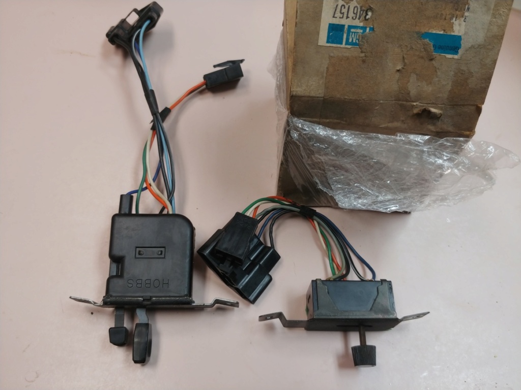

Yes, they are somewhat rare depending on what part of the country the vehicle was sold. Here in the Houston area they were a little more common since we typically get a lot of rainfall. My 75 Laguna has them and the 77 El Camino I sold a few years back had them as well. There are 2 different designs of the switches. The first version was available in 75 and 76 which I have pictured below. It has a slide knob with a separate washer pump button. The 77 version is a single round knob that you turn clockwise or counterclockwise depending on the amount of delay you want to be set. Then you would depress is for the washer function. Here's a side by side comparison.

And, of course, you need the special wiring pigtail that runs out to the optional wiper motor designed for pulse wiper function. I do believe any pulse wiper motor from any GM car thru the '70's will work. They all mount up just like the std wiper motor. It's an easy upgrade if you have the parts. Recently added it to the Laguna. I've only found maybe one car among many dozens here in MN with it. Oddly, I usually find them at DVAP in AZ when I'm down there.
