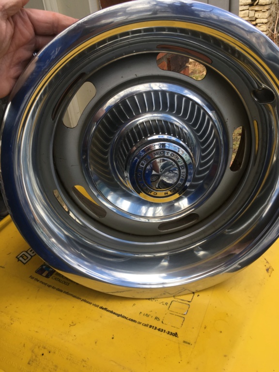

I have considered for years about going back to my stock rallys but I do like the stance of the 8 inch wheel that I’m currently running. Last fall my wife and I stopped by a garage sale and there set one Vette rally in the garage. I joked with them and asked do they have the rest. They said they were in the basement and shot me a price I could not believe. I kind of felt bad because I more or less stole them. Three are great, one has a bend in the outer rim. Anyone had any luck in fixing one or should I just find one more?

I would just find another. They are all over the place for sale. Trim rings not sure where you would find a step ring for 8 " rally

I know it may be hard to believe, but that shouldn't affect the sealing of the tire or being out of round by the looks of it. The tire actually seals on the inside of the wheel. I would try and bend it out as best you can and have it spun on a tire balancer to see if it's bent or runs out straight, Then you could always put on a used tire to see if it holds air. Just my two cents sir.

If the bead isn't damage it might be okay. If it is, call a wheel repair shop to see if it can be repaired. Most around her only do aluminum wheels though. And it might cost more to fix that replace.
I bought a set of truck Rally's years ago for my old Suburban. The rims looked fine until they were on a balance machine. All four were bent and out of round. I couldn't fix them, they were essentially junk.

find another and use that one for a spare

I bet you can hammer it straight. I had a bent one that wouldn't balance though. Might want to check them out before refinishing. Summit sells them too. I agree on the trim rings. I'd like to get the stepped set as well.
