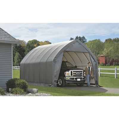

As far as temporary storage this may be a good option. You can get these for around $500.

If you buy one of those portable garages get a good one dont scrimp. You dont want it collapsing and some I believe have ventilation. The brand coverit comes to mind.

Thanks for the input on storage. I am not fan of those protable garages, but it may be my best answer for now. Or maybe I will just see if I can keep it at the garage its stored in year round for now, despite the inconvenience.
