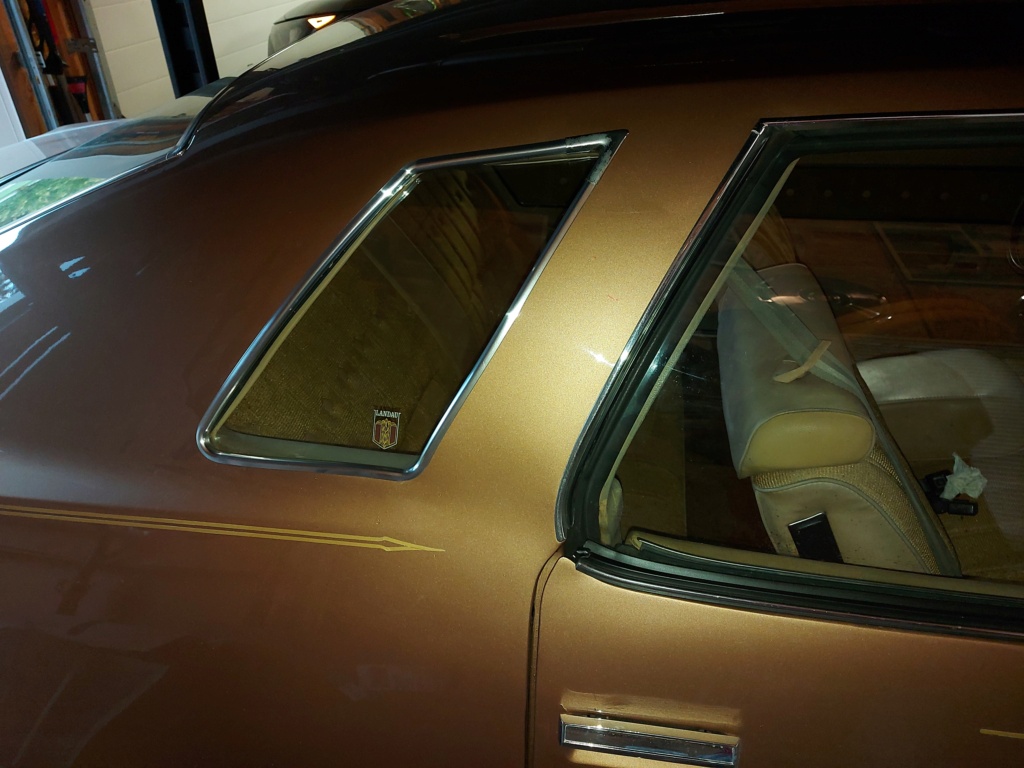

I found an old post here that said to warm the trim in a bucket of hot soapy water and slowly work it in. I took a chance and persuaded the trim to follow the windows shape and was able to get it to work ok. It is more pliable than expected (the original trim is very fragile and brittle). I started at the lower rear corner and worked the bottom edge to the front corner. Then I slowly worked each outer edge. I also had to trim the length by about 3/4" to 1" on each arm. Both the front and rear edge have to be forced to fit as the angles are wrong, but the plastic can be forced to follow the window shape. Once the stainless corner moldings are installed, it holds them in place fine. It looks much better than the old trim, but I am not impressed by the poor fitment, especially for the high price.
Here is the repro trim (bottom) verses the OEM (top). Note the significant difference in the angle.
![Opera Window Trim 20230710](https://i.servimg.com/u/f49/18/72/83/09/20230710.jpg)
Here is the new trim installed.
![Opera Window Trim 20230711](https://i.servimg.com/u/f49/18/72/83/09/20230711.jpg)
