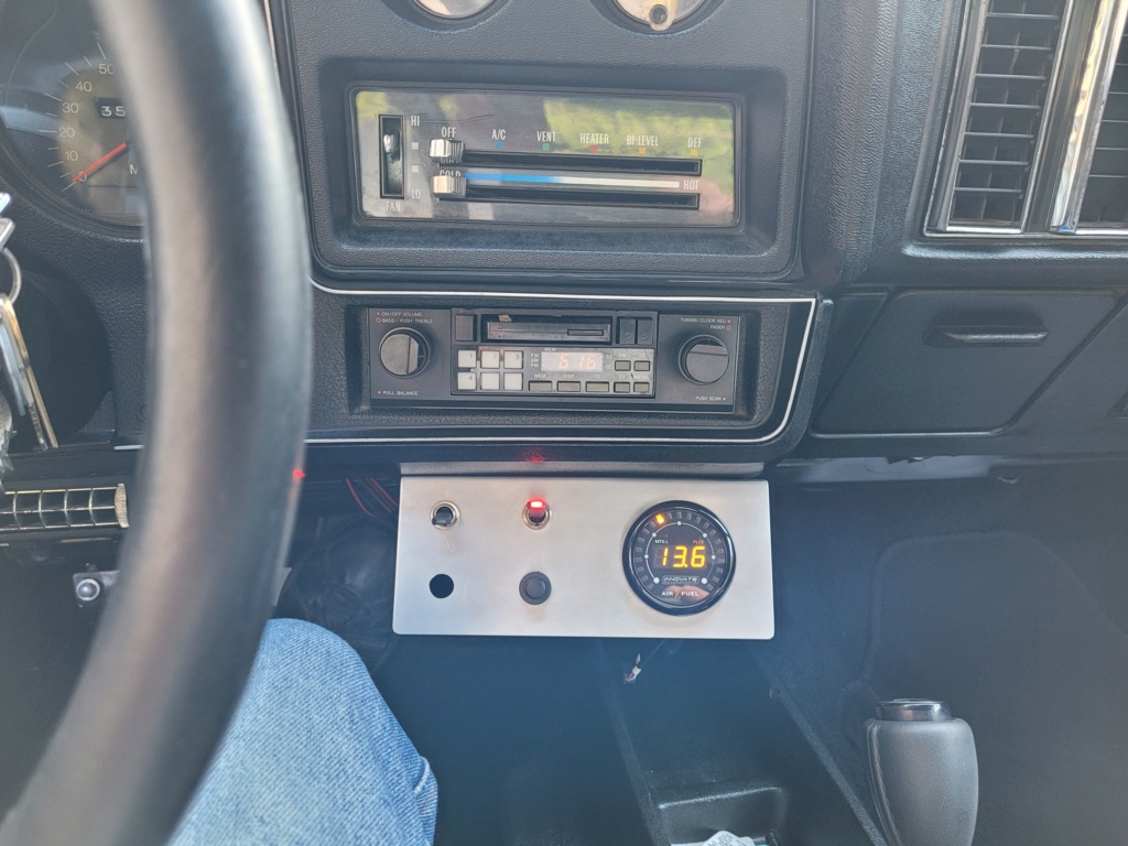

Another reason I love GM cars.   20230810.
I needed a place for some switches & AFR gauge and fabbed this up. I can glance at the gauge without moving my head and the switches are within easy reach without having to lean to reach them. Drilled 2 holes in the bottom of the lower dash, used some large washers to distribute the load and not crack the dash. If I remove it, The holes will not be seen. Plenty of room around my leg & knee.
