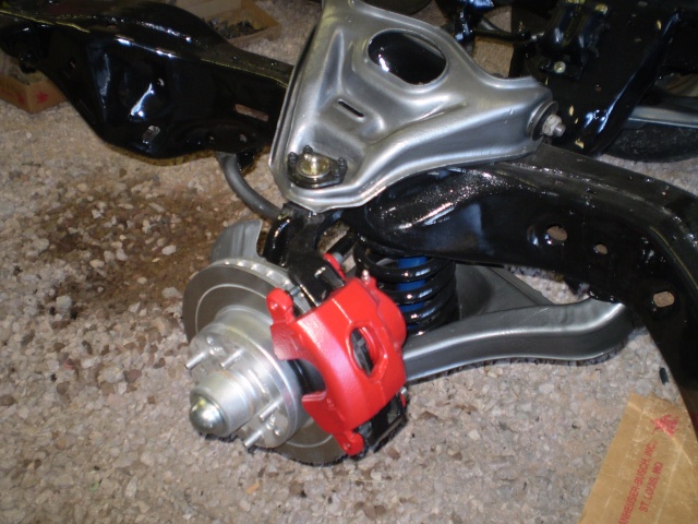

POR-15 is awesome Roadcaptain it is self leveling. I brushed my whole frame, rear housing, upper and lower control arms, sway bars, everything! Make sure and do 2 coats like the directions say, and get some rubber gloves cause that stuff does not come off your skin after it dries!!!! (well 2-3 weeks anyway) Another trick is if you want parts other than black do your first coat, let it get tacky and rattle can it with the color you want. Make sure to get a good spray paint though. This gives you the protection of the POR and the color you want at the same time.

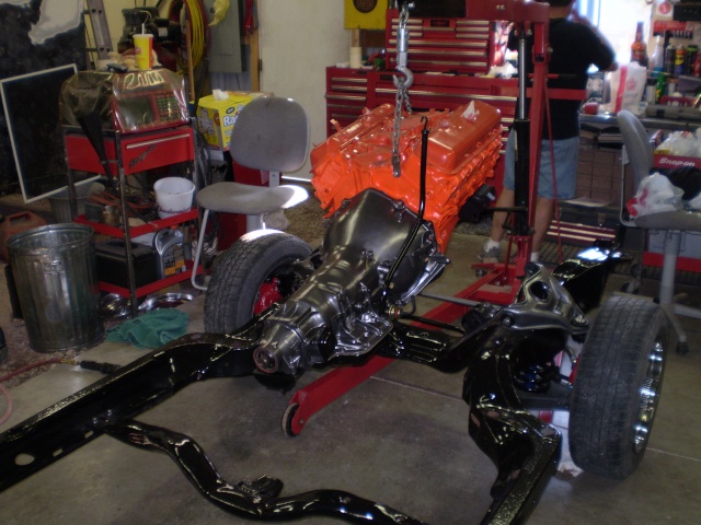

Here are sum pics[img]
[/img][img]
[/img][img]
[/img][img]
![Funky Engine Bay.... Laguna20](https://i.servimg.com/u/f65/13/75/97/56/laguna20.jpg)
![Funky Engine Bay.... Laguna21](https://i.servimg.com/u/f65/13/75/97/56/laguna21.jpg)
![Funky Engine Bay.... Laguna22](https://i.servimg.com/u/f65/13/75/97/56/laguna22.jpg)
![Funky Engine Bay.... Laguna23](https://i.servimg.com/u/f65/13/75/97/56/laguna23.jpg)
