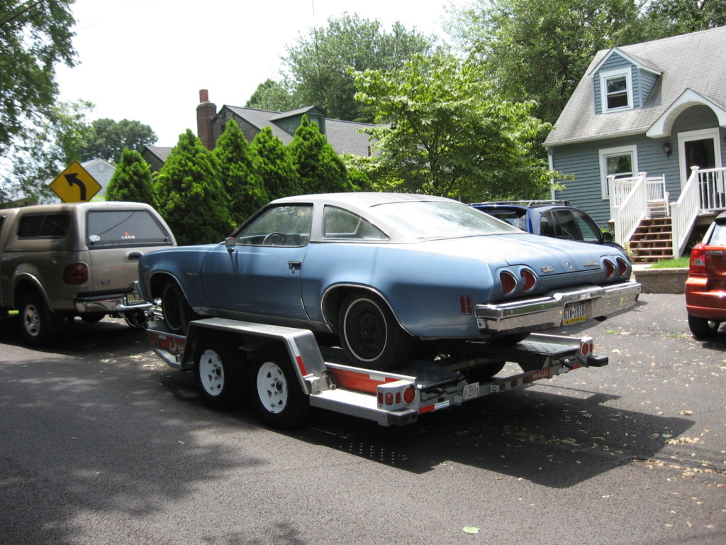

Well I figure Its about time to start a thread on my car now that Ive had some time to finally start working on it.

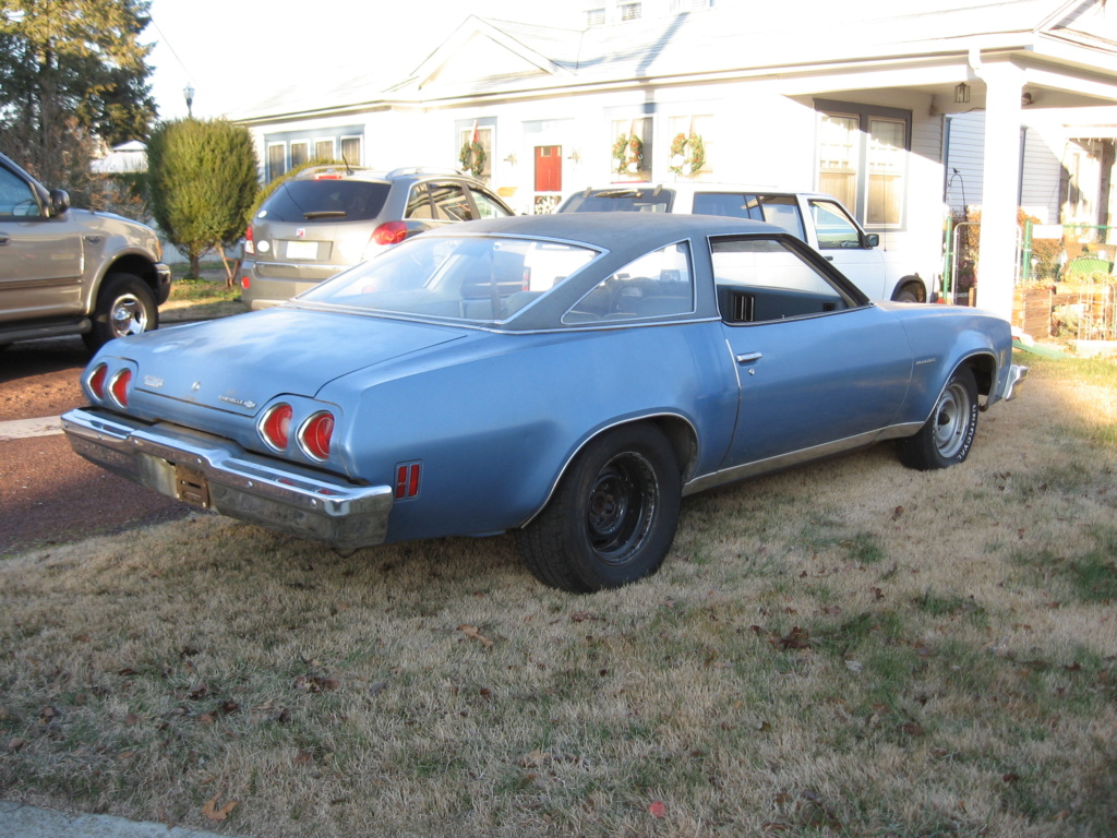

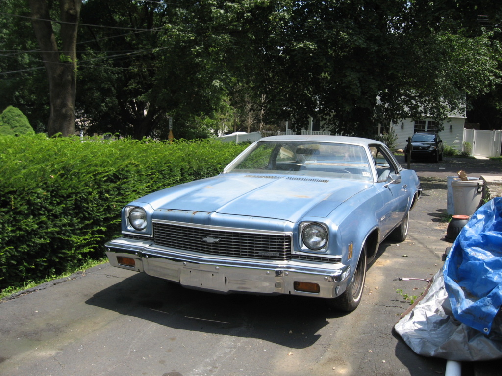

I bought back in July of '09, found it on craigslist about 45min away in PA, got a great deal on it ($1200) and brought it back home to NJ.

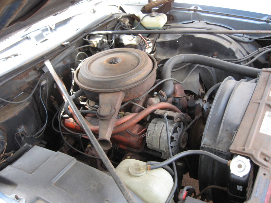

Pretty basic & mostly original 73 Malibu w/ a gutless 307 and only 60,xxx miles on it.

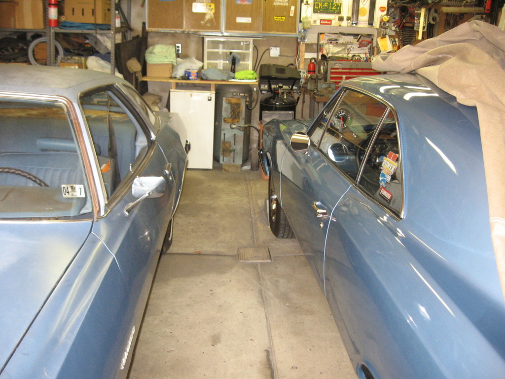

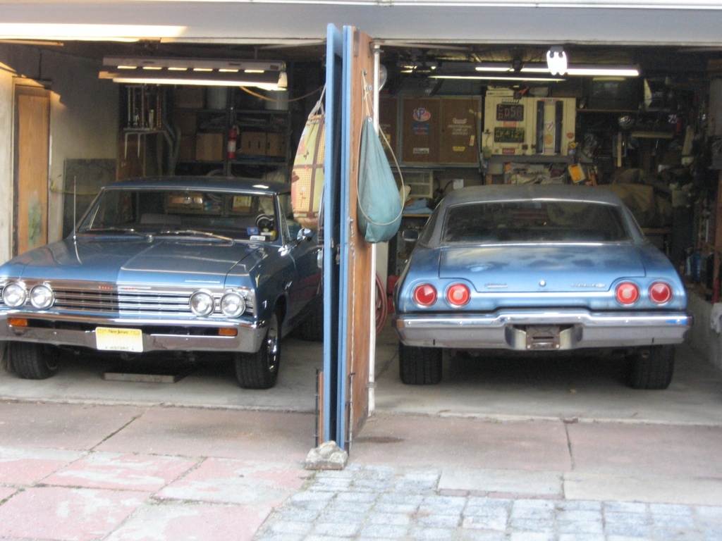

Turns out its pretty damn close in color to my Nantucket blue '67, didnt even realize it untill we put it in the garage next to the '67
Pulled the interior out cause the carpet was all funky from the rear window leaking.

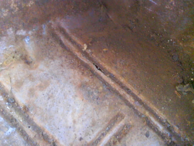

Mostly just minor surface rust
Only a few small spots rusted through
Took off the almost new tires and wheels that were on it and put them on my blazer. Then just threw some random tires and wheels on the 73 that we had laying around.
Then life got in the way and this is were she sat untouched for 4 years..............
.......Until this past April when I found a deal I couldnt pass up on a complete 4.8l from a 2000 Chevy truck.
Will try to get the rest of the pics up later today.

Floor rust is not too bad for that age.
Bumper chrome looks nice too !
On my Elco, I laid a layer of fiberglass cloth with a few coats of West system epoxy, after some minor fixing of rust spots on the floors. The idea being that if the carpet gets wet, it wont rust the floor again...

Ok so this post should take you up to where it sets today
Got some factory bucket seat tracks (non swivel) cheap off ebay and bolted them to some seats (I dont even know what they are from) I had laying around and then bolted them to the floor in place of the bench.
And yes they are tan, but at least now I can comfortably fit in the damn car
(Im 6'5)
Started taking the 4.8 apart to change oil pan & pickup and install a '00 ls1 cam I got dirt cheap, and while I was at it I decided to do new gaskets, valve springs, timing chain and oil pump too.
Motors pretty clean for having 140k miles on it
CtsV pan and new flexplate
Cant find the pics of them, but I used The Car Shop Inc 1" setback plates and just bolted the factory motor mounts from the 307 to them. With those and the ctsv pan on it was time to test fit.
Almost perfect, just need to cut down 1 of the bosses on the side of the pan (its there for part of the oil cooler in a ctsv) Can see the one I cut here (top one in pic)
Its in and bolted up. Never even took the factory th350 out of the car, just unbolted it from the 307, put a higher stall converter in I had, and bolted the 4.8 to it. Will be doing a shift kit as well, just want to get it running first.
Here you can see how far the ctsv pan hangs below the crossmember (floor jack is under the trans not the oilpan)
Put head studs in for 2 reasons, #1 the chinese studs were only $10 more than a set of GM head bolts and I can re-use the studs unlike the TTY headbolts. #2 Im planning on turboing this motor next year and these studs are a little extra insurance to keep everything together @ 15psi.
Swapped the factory steering box out for a 12.5:1 box from a Jeep Grand Cherokee using the pitman arm from the chevelle box and attached to the factory column with a rag joint for a mid 80s chevy truck, and to the 4.8s power steering pump with the pressure hose for a 80s Monte SS. These are the best pics I have of it, didnt take any while I was doing it.
Then started putting it back together (dont have pics of everything cause as usual I forget to stop and take pics
Even the radiator hoses from the 4.8 worked (had to cut the lower a bit)
Biggest surprise I found was the stock throttle cable from the 4.8 fit perfectly with only minor mods to the hole where it passes through the firewall, and shortening it about 1".
(truck on the right)
Re-wired the stock harness from the 4.8 to be stand alone by myself (this took longer than getting the motor in the car) then started laying it out in the car before I wrap it back up. Going to put the computer and fuse/relay block behind driver side headlight.
Got my brother to weld a sump on the factory gas tank to feed the Bosch 044 fuel pump.
Thats as many pics as Ive got right now, working on getting the factory exhaust manifolds to fit currently, then finish the harness, fuel system and exhaust.
