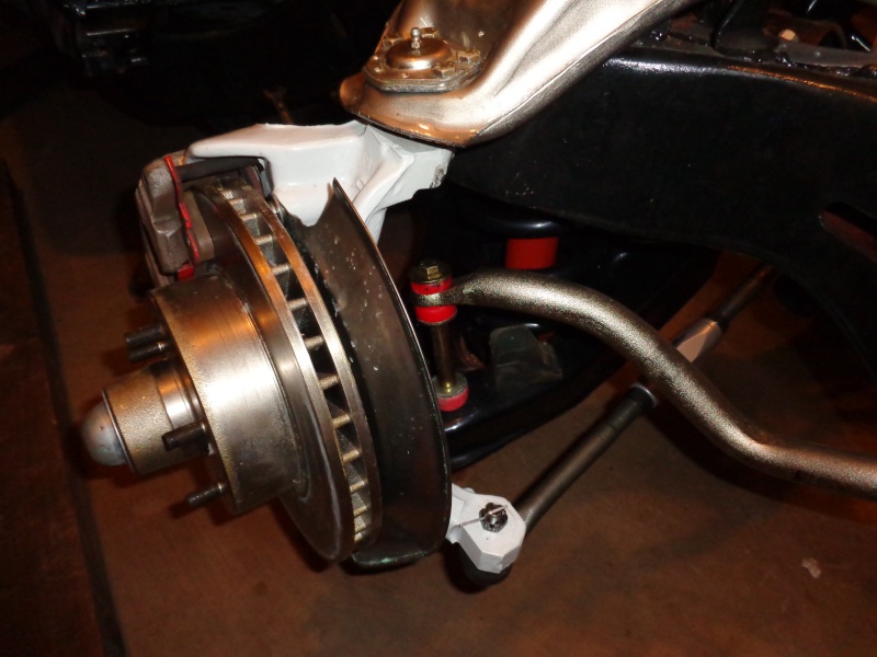

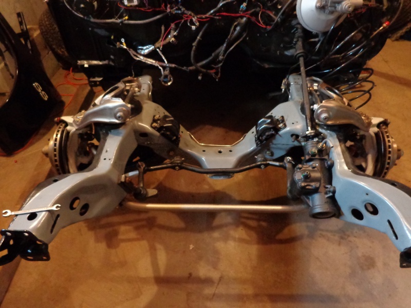

I had some time last night and got the suspension and brakes all back together. now i'm working on the fuel system. i dropped the shortblock off at the machine shop to get new rings,bearings, and rod bolts. i should have that back within a month or so.

Looks Pi$$er!
Is the gray & black frame segments welded together from the new one you got?
Re: 73 CHEVELLE SS PICS
No that's just the way it's painted.
i only cut and welded the rear section of the frame.
