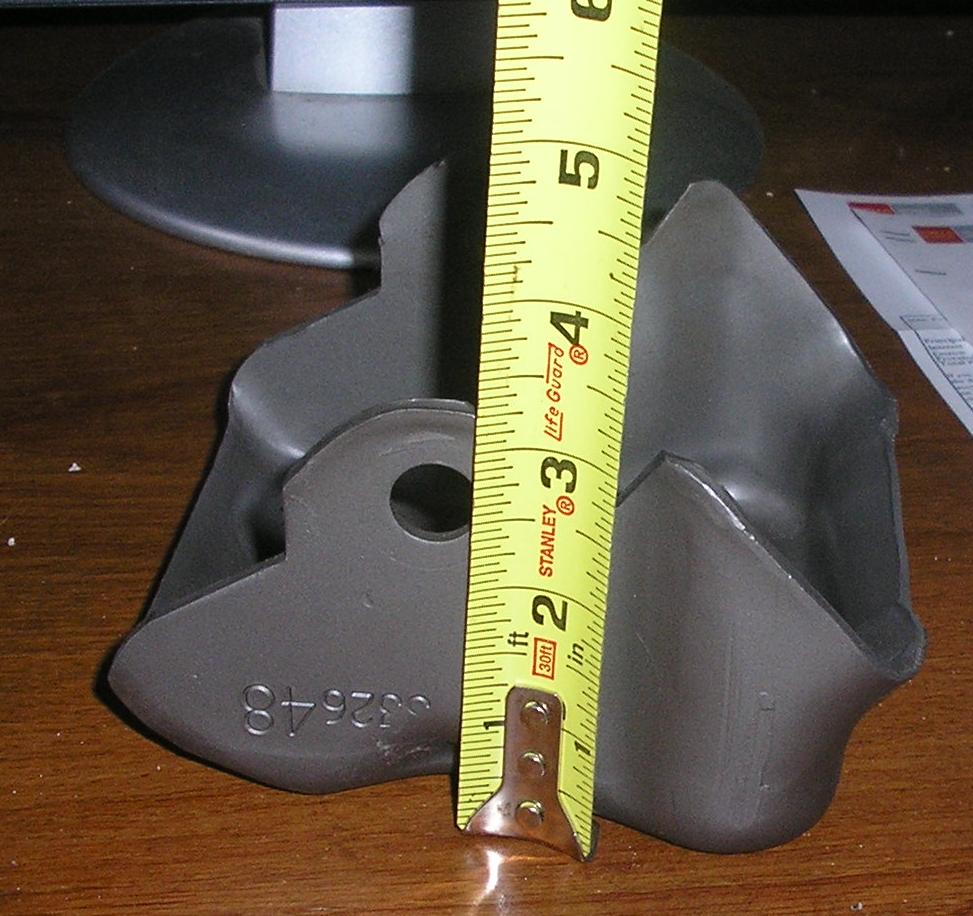

Thanks for the offer Mali!
From what I read here: http://www.nastyz28.com/2gcog/motmount.html I assume small block brackets will work.
The ones I bought yesterday measure 2 5/8", so apparently they are not from a truck according to that site.
Chris: is it possible for you the measure the distance in your brackets?

my 454 clams are 2 3/8.
if memory serves me right,when i put the 350 in my car i tried the 454 clams,but it would not fit.
so YES clams are different it looks like.

So it's the bolt pattern against the block which is different, or the shape as well?

Do you still need measurements? Mike look like the ones you posted from the Camaro site. Let me know.
Re: 1975 Monte Carlo
block is the same, shape is close.
bb on left
bb closest
bb on left
bb closest
Man, hard to see the difference for an untrained eye. Thanks Chris!
Mali: you don't have to bother, seems like I have to find some big block brackets now.

Since the 454 mounts only measure 2 3/8" from the bottom to hole centerline I assume the engine will sit lower in the bay compared to small block mounts. But if there is enough room under the hood, maybe it wont be an issue.

Picked up the mounts today:
http://www.ebay.com/itm/GM-454-CHEVY-ENGINE-MOTOR-MOUNTS-A-B-1973-90-11467-11609-/190769347388#ht_3007wt_806
However, they don't measure 2 3/8" from the bottom to the hole centerline like yours Chris. They are just under 2 7/8". Truck mounts?
Can this 4/8" difference really cause a problem? I doubt it. Hoping to get the engine in during the weekend.

Fishgrinder wrote:Picked up the mounts today:
holy shite. im sorry.
im not realy sure. but i guess if you put all 4 of them on the motor than set it in the cradle,you can drill new holes. now im stuck.
No worries man! Just to be sure, this is the distance you measured and got 2 3/8?
I also have the 2 5/8" small block pair, which probably will fit according to Bruisr.
But hey, can 1/2" really cause a problem?
