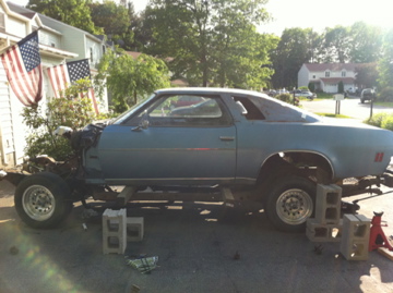

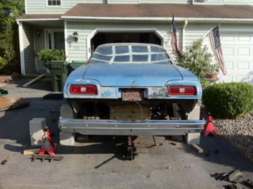

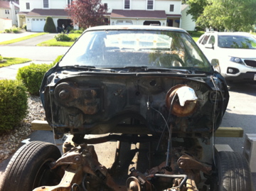

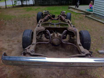

So after 8 hours of working on jacking up each corner 3 inches at a time to clear 3 feet, I finally got the frame out. Getting ready to blast the frame now. Here's the pics, let me know if you see anything else that needs to be taken off (I've already removed the power steering pump and rear bumper)

Good luck. I will be waiting to see the finished product. Yeh, its a lot of work. JB
Re: Frame OFF!!!
Are you going to break it down more and take off A arms, control arms, sway bar etc? Replace bushings? Just wondering cause if you have it that far apart you might want to do that.

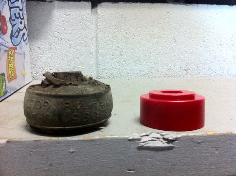

So I got my body mount bushings in the mail, but something tells me they're not the right ones. I got the '72 convertible set.

The hole diameter looks the same. The old one's probly compress when the body is on them and the new urathane one's wont compress so that is probly why they look different. I am not sure just a gues hope some one can tell me if i guessed right.
Jedediah- G3GM Member
Re: Frame OFF!!!
Jedediah wrote:The hole diameter looks the same. The old one's probly compress when the body is on them and the new urathane one's wont compress so that is probly why they look different. I am not sure just a gues hope some one can tell me if i guessed right.
....Maybe. However, they look a lot shorter as well....

HB2132Z
(1973 - 1977 GTO/LeMans) BODY BUSHING KIT (KIT IS MADE OUT OF RUBBER WITH STEEL SHELL INSERTS. TWO OF THEM ARE SOLID RUBBER PLUGS & THE TOP CAP BUSHINGS HAVE STEEL WASHERS MOLDED INTO THEM JUST LIKE FACTORY. THESE REPLACE ALL GM NUMBERS: 330942 (4), 457915 (12), 330955 (4), 377801 (2), 6271662 (2) & 330951 (4) - ALL BUSHINGS HAVE THE GM NUMBER ON THEM) - 28 PIECE KIT
looks like the 330951 is what is on your rubber

Mine are the stock rubber type, from the Parts Place like I mentioned, and should fit '73-'77 A bodies and El Caminos like mine. They may have the hardware too, bolts etc. I used the old hardware, since they came out easy and shiny .
Re: Frame OFF!!!
I'm almost tempted to just use these. There's a few of the old ones that are still in good condition, but I don't know how they'll match up with the new ones.
Re: Frame OFF!!!
I would be inclined not to mix old with new, since it's liable to stress the body a bit when they are torqued down. I guess you could shim the old ones to match the new ones (?)
Re: Frame OFF!!!
I'm back sorry so long. Been workin on car. Finally painted and puttin back together. Did they work? I hope so cause thats what I used and it worked and its all bolted down and painted. Let me know
