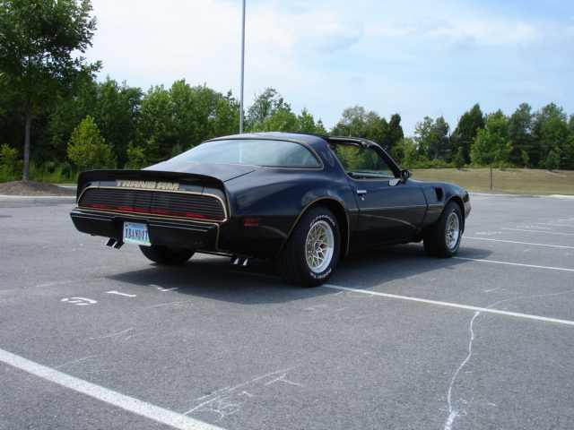

Post by Limey SE Wed Apr 30, 2014 10:26 am
your so close to the rear of the car anyways why not just bring it to the rear on the side, or even try the dual tipped tip's like for the Trans Am in the day, I have always wanted to try them on our type of car, just no luck finding any used ones to try it
