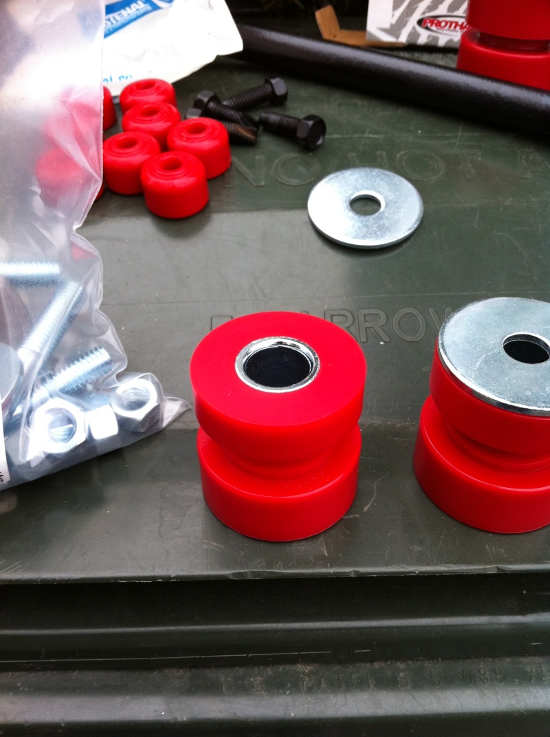

So I've got the poly bushing body mount kit and figured out where everything goes, but my hardware has gone to crap (i.e. twisted, corroded bolts and metal bushings.) I went to Fastenal and got 14- 7/16" bolts with washers that match up to the width of the old ones. four of the poly bushings I know are just supposed to set on the frame, and the other 10 are supposed to mount to the frame. My problem is, two of the 10 have a larger hole in the bushing than the other 8. I've found sleeves for the bigger ones to fit in the bushings, but my only concern is putting a 7/16" bolt in still leaves alot of room for play. I also need to know how long the sleeves need to be as I am cutting them from a steel pipe. Also, the directions that came with the bushing kit don't make sense as a few of the bushings have the larger end under the frame rather than on top. If anyone has installed poly bushings, please shed some light on this for me.

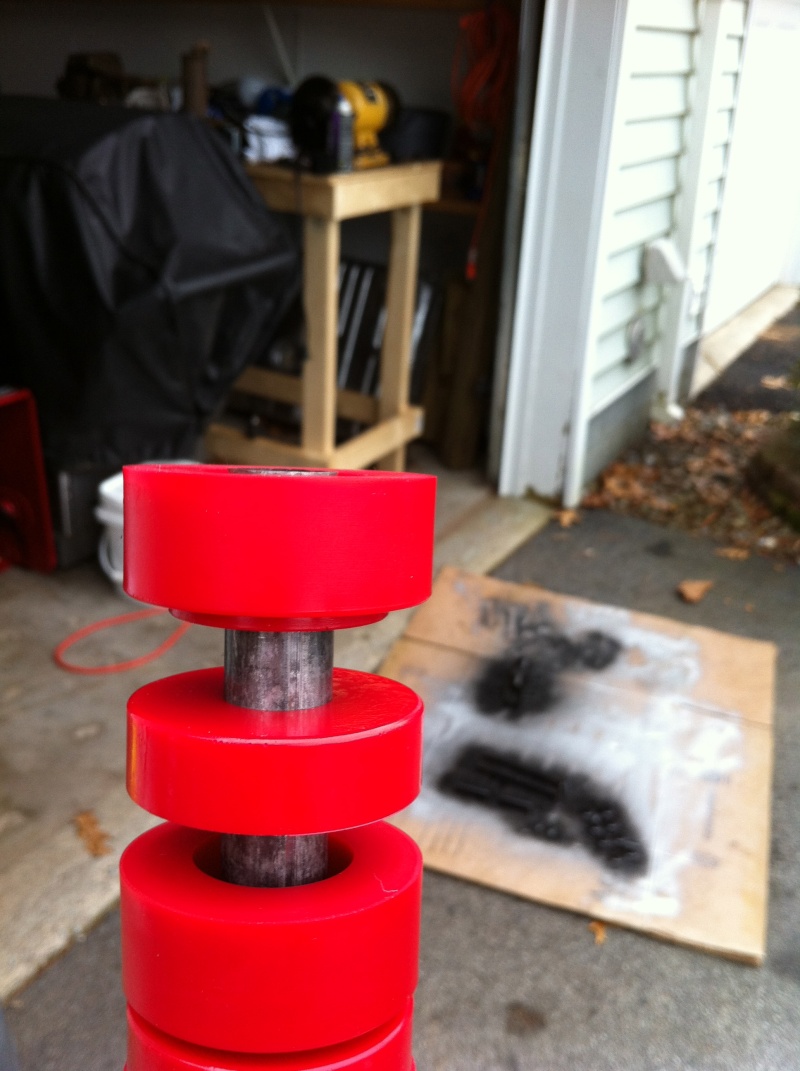

I ordered the 68-72 Chevelle body mounts and ended up with 2 extra mounts, yet no hardware. (They are also the poly ones too) They fit in the slots perfectly on the frame, but I'm having to MacGruber the hardware using sleeve inserts I found at Lowes (in the first pic) and 3/4" pipe for the other ones (in the 3rd pic). My only problem is the amount of room inside the spacer for the bolt to move around. The only other thing I can think of to solve this is to fill the sleeves up with JB Weld and then drill a hole through to fit the bolt.
