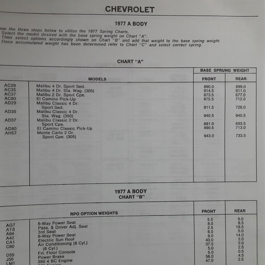

Hollander Interchange wasn't much help. They only show generic interchanges for coils. I referred to my 1977 GM Chevrolet Parts Illustration manual and they confirmed your rear springs as #485722 for "sprung weight" of over 686 lbs using FR78-15 tires...over 701 lbs using GR70-15 or GR78-15 tires...or, over 736 lbs using HR78-15 tires. BTW...your stock "sprung weight" for the rears is 699 lbs.; and, add to that various options added to the car. Your stock "sprung weight" for the fronts is 890 lbs...but, the part numbers shown in my manual do not match what you are showing regardless of added weight for options or tire sizes. Attached is a list of options they show with added weight in determing final "sprung weight". Hope this helps.

Thanks MCarlo. Believe it or not the 77s have different front coil part numbers compared to 76! (378585 vs 2672883)
Also GM had the sneaky habit of updating their specs in later years. I am referencing the 76-81 Parts manual and their (updated) base front weight for the Classic sedan is 943 pounds while the wagon is 968 and the Coupe is 895. With the options on my car it is well over 1000 pounds up front and over 750 in the back.
As far as their specs go, I recommend always checking up to 5 years after the initial date. They seem to give up adjusting after 5 years.
