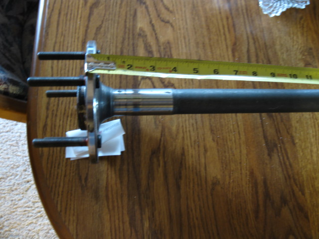

Post by bigredlaguna Tue Apr 24, 2012 6:35 pm
[img]Stock Axle Length Img_5710[/img][img]Stock Axle Length Img_5711[/img]
This is what I have waiting in the closet for install.

Stock Axle Length Empty Re: Stock Axle Length
Post by 74Malibu383 Tue Apr 24, 2012 6:52 pm
Those look nice! Are they a factory replacement? What brand? That measurement falls in-line with Moser's specs.
Post by bigredlaguna Tue Apr 24, 2012 6:57 pm
They are Moser axles. Craigslist find for me.

Post by 74Malibu383 Thu Apr 26, 2012 12:16 pm
Thanks for the info. Are you confident that these aftermarket axles are the EXACT same as our stock ones? I ask because I can't change the location of my wheels at all. Even a 1/4" would be a nightmare.
Post by bigredlaguna Thu Apr 26, 2012 3:23 pm
Here ya go Bryan:
1974 axle out of my old car
[img]Stock Axle Length Img_5712[/img]
Measured the same way as my aftermarket axle.
[img]Stock Axle Length Img_5713[/img]
Proof
[img]Stock Axle Length Img_5714[/img]
Street Cred : 53
TW Monte likes this post
Post by 74Malibu383 Thu Apr 26, 2012 4:11 pm
Sir - You rock! Thank you. Beer

Post by 77mali Thu Apr 26, 2012 4:34 pm
74Malibu383 wrote:Those look nice! Are they a factory replacement? What brand? That measurement falls in-line with Moser's specs.
Product Description
Part #: A102812 (1-Pair)
Mfg: Chevy
Model: Chevelle, El Camino, Malibu, Monte Carlo
Year: 1973, 1974, 1975, 1976, 1977
Rear End: 10-Bolt Chevy
Spline Count: 28
Length: 30 5/16" long,
Bolt Pattern(s): (2) 5 x 4 ¾” (.480” Knurl press-in & 1/2” X 20 threaded)
These forged steel street axles for your stock OEM application are non-tapered, with hardened & ground bearing seats and machined c-clip grooves.
Our replacement c-clip axles are available in any length up to 37”. If you choose to narrow your rear end at a later time, these axles can also be shortened and resplined.
So then we can assume that they are all 30 5/16", as per what Moser states? Sure looks like the 74 axle is. That's good info gentlemen.
