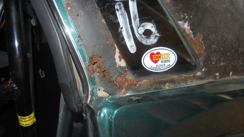

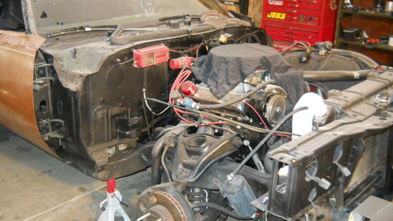

Rust free doors, decklid, and fenders are on. Rust behind the window has been fixed. This is a race car, not going for perfect. lol

Cover it up with a new padded vinyl top. Its too bad so many of these cars suffer this fate. Someone really should stamp make a patch for that area.
Re: New Wheels, lowered, rust fixed and primered
First thing to do with a vinyl top......RIP IT OFF ! Luckily mine had just surface rust........

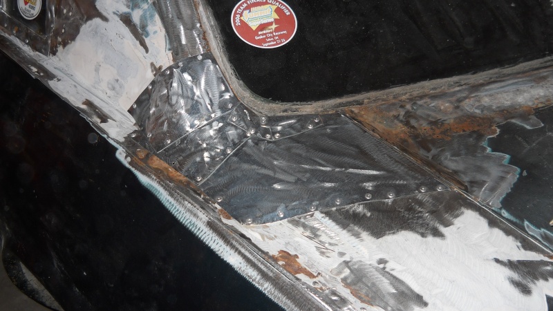

You could heat up the rivet heads & knock them down a bit w/ a hammer & dolly or a big enough nail set before applying filler.
Dubie- G3GM Newbie
all the metal was heated and beat down fiberglassed sanded another coat...

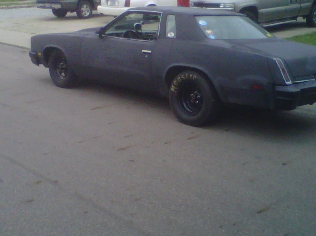

Primered, dropped, new wheels
Ready for the vinyl wrap for 2013, dropped, new wheels, primered no more rust.

LEAVE IT LIKE IT IS!!! Looks meeaaan.
Malicruiser- G3GM Member
I say leave it as is that thing looks bad A$$ in all black !!!! I may be partial Black now though LOL
Its a race car, make it a glossy color. JB

Looks good! I love that stance- how much meat did they cut off the coils?
2 1/4 coils, guy said they were the biggest springs hes seen. lol. I have a very good friend that will do the wrap at cost of the vinyl if i put his logo on the car. Also in the middle of working out a deal for a fuel sponsor.
