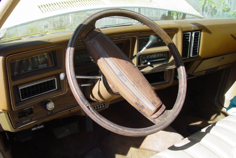

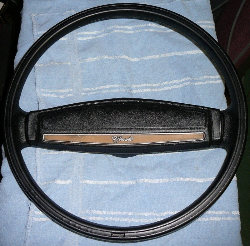

Here's a b4 & after of my steering wheel. It's not perfect but will do for now. Will be doing a second coat and experimenting with a "clear" for plastic too for protection- that I've not tried yet.

Re: Painting Interior Plastic
Nothing wrong with that. Looks good to me.

Thanks Ghost! If you look close there's a bit of the color under the Chevy logo along where I had to reinstall it back into the horn pad. Will be taping it for the 2nd coat to avoid that again. Was trying to spiff up the logo-lol.
