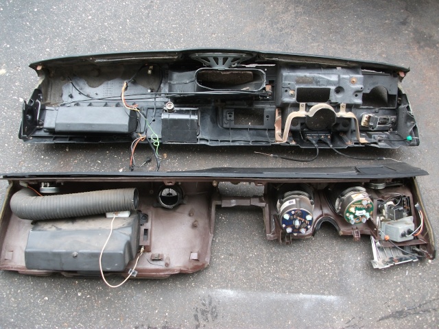

I want to know if a dash from a 74 Olds cutlass will swap over. It has round gauges and round vents and i think it would look good. My dash is trashed and the wiring is not something you would want. I would of course try to remove the olds signs.
Jedediah
Jedediah
Street Cred : 4
Compatible parts Empty Re: Compatible parts
Post by Mcarlo77 Fri Jun 17, 2011 5:51 pm
I've got one of each in my basement...could take some measurements and try and make some comparisons of both. Suppose with enough ingenuity and patience, anything is possible. Obviously, you'd want to grab the complete wiring harness and ducting from the Cutlass.

You have both in your basement nice. If you would that might save me some cash and a headache if its not possible. So i would need the complete wiring harness from the entire car? I was thinkn i would just need the fuse block and dash wires? I am hoping its an AC car i didnt get to spend alot of time going over the car was just thinkn i would snag the plastics but i realy like the dash in it and the more i think about it the more i want to do it. Something different.

Here is a photo of the backsides of the Cutlass vs Monte Carlo dashes (Cutlass on the bottom, of course). Couple of observations...the overall length is about the same at around 59 1/2". However, the mtg bolt locations used to secure the dash to the car are not similar...not that a person couldn't probably improvise. Looks as though the upper defrost vents are in the same general location...but, whereas the Monte has two upper attaching screws on either side of each defrost vent, the Cutlass does not. Instead, it has four mtg tabs spread out evenly along that back edge. The lower dash mtg bolt tabs are completely different. Maybe have to cut or fabricate some brackets? Aside from that, I don't know what else to compare. Obviously, the underdash wiring harness will be completely different. Not sure if the two cars share the same heater box to avoid any clearance issues, either. About the only way you are going to know for sure what you'd be getting yourself into is to drag that dash home and hold it in place in your monte and see what's involved. If you have any other questions, give a shout.

Here's another shot of the front of the two dashes for comparison.

Thanks Mcarlo77 not quite what i was hoping for. I was hoping the mounting points would be the same. Atleast the length is similar. I am sure i could make it work i have seen a 73 el camino with 2006 GTO interior.

wow, thats a bare bones 73 Monte dash! Who's is it? I'm sure thats worth something.
