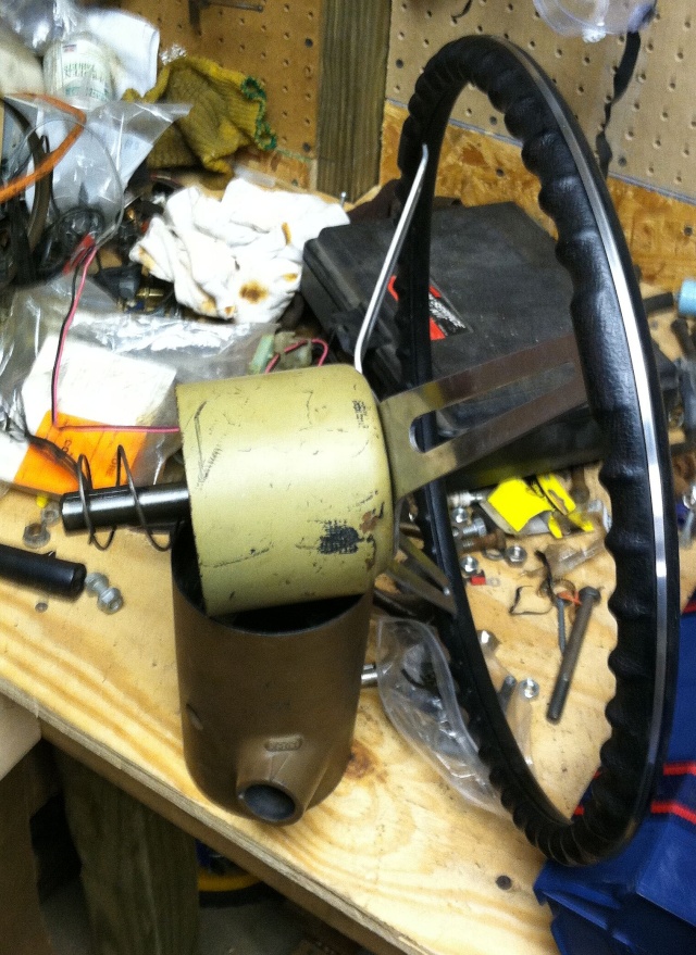

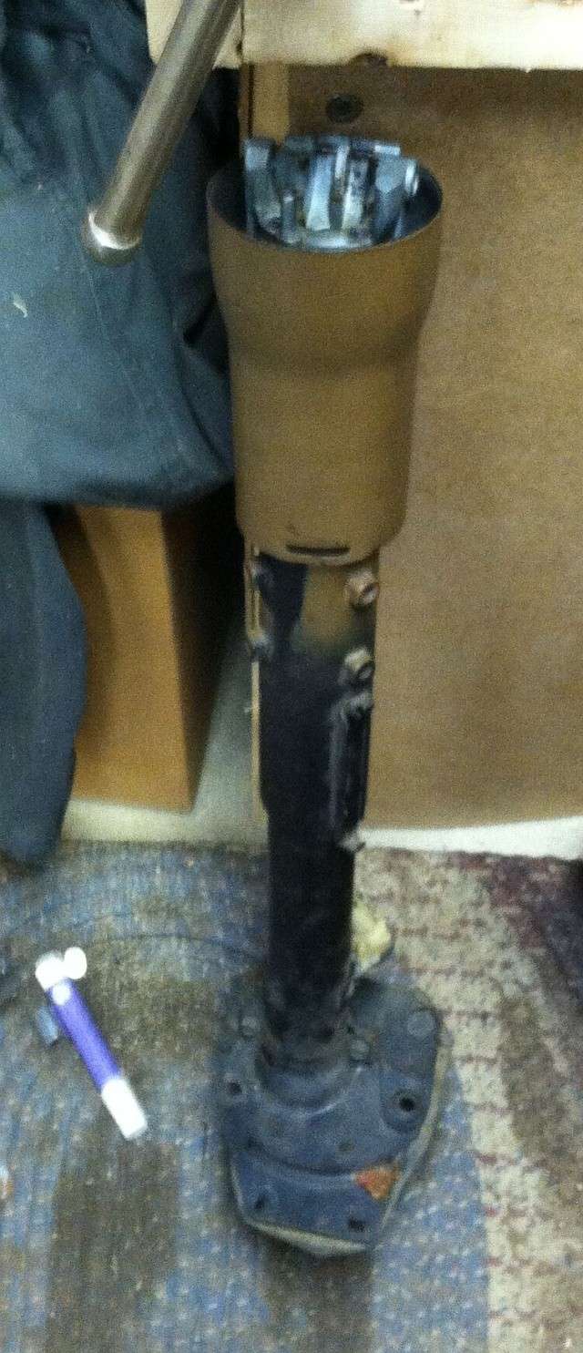

yep thats what im trying to do. about 1 1/2 years ago i bought a 76 corvette tilt/tele column for 40.00![converting a g3 column to a tilt/tele Tel1110](https://i.servimg.com/u/f74/12/69/99/95/tel1110.jpg)
while looking for limeys spring and bolts he needs for his SE column, i found a half torn apart monte column.so i took the parts from the vette column and put them on the monte column.
![converting a g3 column to a tilt/tele Tel1210](https://i.servimg.com/u/f74/12/69/99/95/tel1210.jpg)
![converting a g3 column to a tilt/tele Tel1310](https://i.servimg.com/u/f74/12/69/99/95/tel1310.jpg)
the only problem is 76 used only one style steering wheel,and i dont like it.
![converting a g3 column to a tilt/tele 05271110](https://i.servimg.com/u/f74/12/69/99/95/05271110.jpg)
i would use it if it was black,but this one is brown![converting a g3 column to a tilt/tele Icon_f10](https://i.servimg.com/u/f74/12/69/99/95/icon_f10.gif)
now i found a kit to transform the 76 column into a 69-75 column, so i can use my (vette) steering wheel.
![converting a g3 column to a tilt/tele Old_wh10](https://i.servimg.com/u/f74/12/69/99/95/old_wh10.jpg)
but last time i found it on fleebay,it was 200.00.![converting a g3 column to a tilt/tele Icon_p10](https://i.servimg.com/u/f74/12/69/99/95/icon_p10.gif)
yes i have a black 4-spoke steering wheel,but the backs are not the same and i cant use it. the vette wheel has this other piece behind it for the extra stuff.
![converting a g3 column to a tilt/tele Cor110](https://i.servimg.com/u/f74/12/69/99/95/cor110.jpg)
so i guess i will just wait and see what i do when i redo it this year.sorry i got carried away,just trying to share.

took a 1.5 hour drive to a guys house that had parts for my project. spent over an hour looking for the right stuff to make this puppy work. now time to take it back apart and paint it.

spent yesterday taking it back apart![converting a g3 column to a tilt/tele Cola10](https://i.servimg.com/u/f74/12/69/99/95/cola10.jpg)
![converting a g3 column to a tilt/tele Colb10](https://i.servimg.com/u/f74/12/69/99/95/colb10.jpg)
![converting a g3 column to a tilt/tele Cold10](https://i.servimg.com/u/f74/12/69/99/95/cold10.jpg)
![converting a g3 column to a tilt/tele Cole10](https://i.servimg.com/u/f74/12/69/99/95/cole10.jpg)
and painted everything![converting a g3 column to a tilt/tele Col210](https://i.servimg.com/u/f74/12/69/99/95/col210.jpg)
put it back together this morning using the 3 spoke wheel and found 2 of the same levers
![converting a g3 column to a tilt/tele Col310](https://i.servimg.com/u/f74/12/69/99/95/col310.jpg)
![converting a g3 column to a tilt/tele Col410](https://i.servimg.com/u/f74/12/69/99/95/col410.jpg)
i tried using the 4 spoke wheel,but found i did not have enuff movement for the lock/unlock between the spokes.
![converting a g3 column to a tilt/tele New_wh10](https://i.servimg.com/u/f74/12/69/99/95/new_wh10.jpg)
i might put the 4 spoke in the caprice,but i really like the rope 4 spoke thats in it now also.

also bought a cylinder with matching door locks. so since my dash is blacked out,i thought the column should be too.
![converting a g3 column to a tilt/tele Tt210](https://i.servimg.com/u/f74/12/69/99/95/tt210.jpg)
