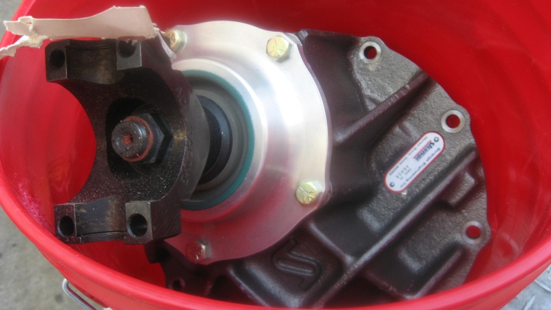

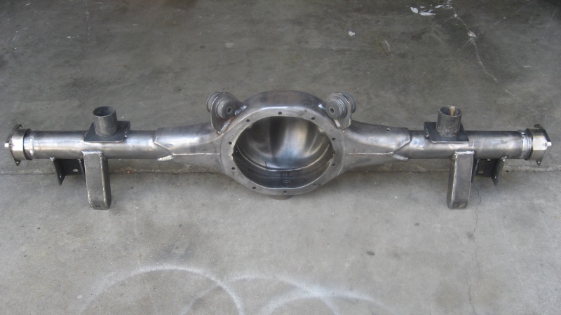

Southside lower control arms and adjustable uppers, the diff.is from quick performance, Strange Detroit locker h.d with 3.89's, Moser 35 spline axles and a 2500 stall, 4L80E built to hold, power at over 1300 h.p at 5500 rpm and torque over 1400 at 4400 rpm, seems to hold very well. With the F-2 the rpm can get away at times when the tires get loose it's went to 7800 rpm.
At around 6000 the boost is growing to about 15 lbs and it's not recommended to go past that, (so the 7800 is kinda scary) been there a few times !!

Now thats what I'm talking about!! How did you choose your nine inch rearend width?? Did you get it stock width from axle flange to axle flange?? did you compensate for any special disc brake setup for width?? and did you use the stock control arm mounts? Thanks in advance.
I'd bet a guy could spend just about as much on a ten bolt buildup as a nine inch too, well maybe a few more bucks for the nine, but well worth it for sure,
that feeling of an assured foundation for power must be great.
