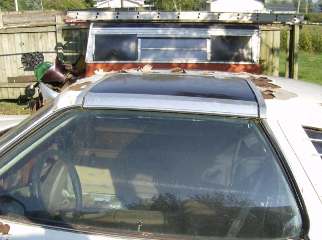

I was concidering a trade for a trans am with t tops just so i would have a car with t tops again when it struck me. Just find a regal,cutlass or grand prix with t tops thats being parted out and put them in my car. I found a 76 regal that had a set up hurst hatches and a NEW set of rubber seals. I am picking it up right after he cuts the roof off for me should be ready in a day. I paid $500 for everything probably to much $$$ but I have always wanted it.

Don't think $500 is that bad of a deal considering a new set of seals runs about $600. I, too, was considering such a swap on the rusty '76 Laguna and the donor was also a '76 Regal. If I remember right, it wasn't going to be as easy as transplanting the entire roof because they aren't exactly the same, but the front half with the t-tops could be spliced in.
Re: I am putting t tops in my 74 laguna anybody ever seen one with t tops? Or have any pics of one?
Mcarlo is correct...The 76-77 Regal's are notch-back windows (like the Monte's & Grand Prix), whereas the 73-75 "Century or Century Regal" are fast-backs/slant-backs (like Chevelles).
I planned on removing the trim and hardware from the regal roof making a template and cutting out the holes on my roof rather than swapping roofs due to the differences. The guy in buying the roof from has done it before and said he will walk me through it. Retired old school body man

The regal door and window opening are 2 inches longer than mine so it may not work

Guess that would be confirmed by the fact that '76/'77 Regal door glass is not interchangeable with Chevelle's (per Hollander Interchange). Good catch...before you got into it and learned later that this wasn't going to come together like you thought.

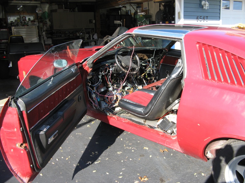

Mine has a metal tab the the glass hooks into in the center T section of the car. Then they used cam latches to hold them in. I'm sure the gasket is not correct for the period but it will work.
I have no clue if they took the roof off the grand am or just the t tops. They appear to have been cut into the roof of the car or to its original roof I was told and reinforced with steel. The guy I got the car from said the person he got it from stood on the t-top section to prove it was all steel reinforced. I know the lovers on my large triangle windows match those on a grand-am or a can-am style car.
Remember my car is a stock 74 Malibu with all thees mods done to it so I have no clue what it all came from.

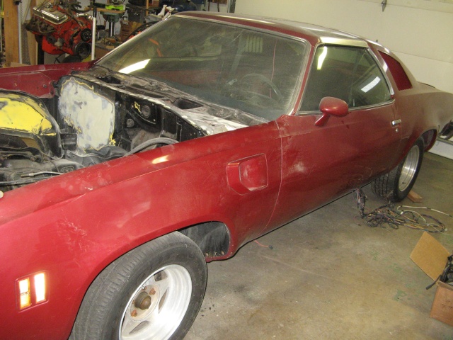

Yours looks like they grafted a cutlass roof to it. It's totally different than the roof I bought.

Yes the guy grafted them in. I'm sure it was a lot of work.

Hey wallyuph, What ypu got going on with the rear quarter windows there? Can you describe how you did it? I like it! Looks really good! My 74 has the same style, I'd like to do something with them but don't know what I could do!

Bruisr, I must confess I did not do the work. It was like that when I bought it. I believe they came from a Gand-am. The louvers install first before the glass then the glass goes in up against the louvers. Really hard to wash window like that.
