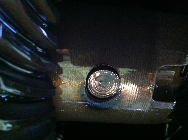

the monte always had a one legged dog rearend.but the last burnout contest i did in 2011 tore something up in it. after that every burnout i did was posi. so i desided to take a look and find out what was wrong.
when i took off the cover i found this
Chris !  Img_0410
so i took out the retaining screw and found out it was brokeChris !  Img_0411
the center pin will NOT come out,and it spins inside the egg shaped hole when the axels are rotated.
Chris !  Img_0412
i have no idea whats holding it in there,but im glad it never came out.that could of been drastic.
i wanted to pull the axels out so i could reuse the backing plates with the posi and not break open the brake lines. but after many attemps to get the pin out,it did not budge.so i pulled out the old....

I've had pretty good luck getting that broken pin out. I did it on an 87 full size blazer, 89 full size jimmy and a 90 suburban. Usually the tip of the bolt breaks off, the part without the threads. If your lucky a nice powerful magnet will work it out. If not, or if a thread or two are still caught, I use a left handed drill bit on an extension and rotate it out slowly. Then use the magnet. Been able to get them out on three occasions.

the pin wont move. its like the screw wore a grove on the inside. it just spins . i put an air chisle to it and nothin.

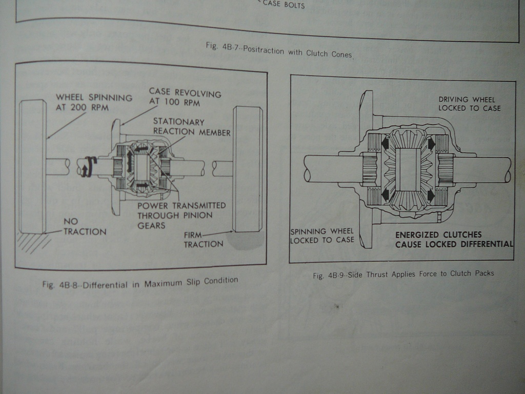

Maybe add a little heat from a map torch w/ the magnet method. Sounds like it's caught on something. I tried to find a good diagram last night on the net & nothing good. I'll look in my service manual too see if it's there.
Chris !  Empty Re: Chris !
Post by 77mali Sun Apr 07, 2013 11:35 am
Here- hope it helps. Looks like there is a retaining washer behind it- maybe it's bent or something?

Since the hole in the carrier is egg shaped, I'd agree that the pin is bent. So basically the pin is shot as well as the carrier. So I'd try to salvage the axles. I say torch the pin out. I'd cut a circle around the pin maybe 2 inch in diameter. Then hit the other end of the pin with the air chisel. Should pop out and then pull the C clips.

thanx joe and mali,im just gonna keep it on the side and work on it one day.
