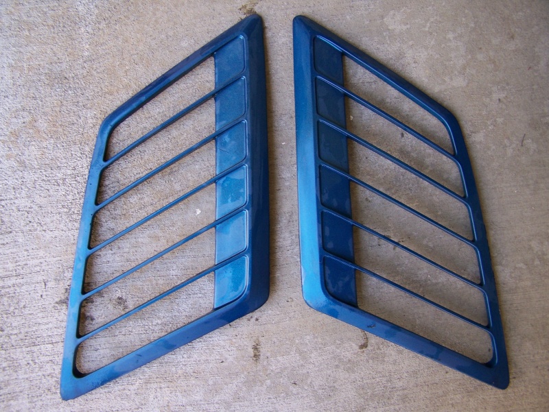

Got these a while back & did a tiny repair w/ some JB Weld fast cure.
Window louvers 76lagu10
Window louvers 76lagu11
Window louvers P1020610
They're mostly really thick & hard plastic.... Laughing
Keep in mind if your car didn't come with them they'll require a hole drilled through the roof in order to install them like the factory did.  Also the interior sail panels are different and the louvers are supposed to be secured through them on the interior side.  I'm dreading cutting my car, it doesn't look super difficult but you really have to be "dead on" with the holes. Limey posted measurements, template info & a little "how to" in the tech section.  I forget where in the section though, sorry.

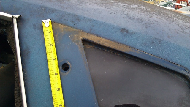

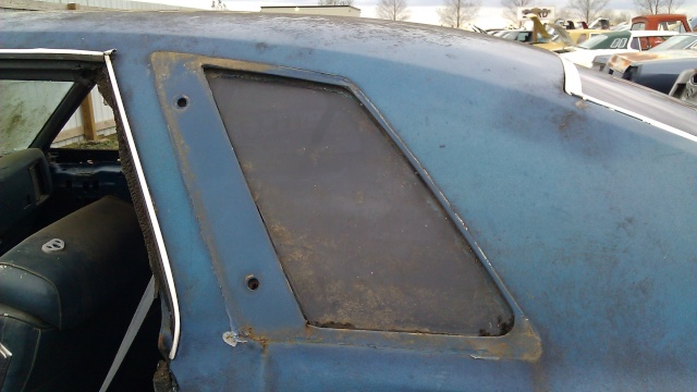

Exterior shot of the two mtg holes and how they sit against the qtr window.

OMG..two holes?  (that's right -two on both sides= 4, LOL)  NOOOOOOO!!!!!

Ever think about cutting off the bolts and using 3M emblem/molding tape to fasten them to the car like the side vents do on new cars. Just a thought here.
Window louvers Empty Re: Window louvers
Post by 77mali Mon Oct 21, 2013 9:25 pm
Wallyuph wrote:Ever think about cutting off the bolts and using 3M emblem/molding  tape to fasten them to the car like the side vents do on new cars. Just a thought here.
Actually yes...do you think they'd stay on @ high speeds or have any issues on really hot days with drooling or sagging? Never used that 3M tape before but I've heard that some of these tapes can fail in extreme heat.
I know that they'll recess a bit into the Qtr windows in the back, so that will help, the problem seems to me up front where the thicker portion of the louvers will rest on the body with contact adhesion being the only form of securing them.

If the backside of the leading edge of the louvers was flat, you would probably have enough surface area to get a good bond using the 3M adhesive.  As it is, I'm not so sure.

The three cars I've pulled louvers from have had no difference in sail panels versus non louvered cars. Definitely not screwed in through the sail panels.

The screws that thread in to the plastic posts have a washer head on them that contacts the inner pillar.

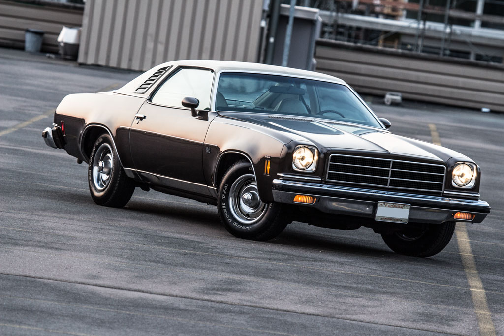

I like to show you why i like to get the window louvers.
I love Original Cars. My chevelle is all Original, original engine, original color, original interior ...
But she looks really classical with the vinyl roof and the small opera windows and not so sportive:
Window louvers Chevel10
I play i little bit with photoshop and create this Image:
Window louvers Chevel11
Only things i need to do:
A second Grille to paint it outside the same brown like the car and inside black, Window Louvers in the same color like the vinyl rood, and a front panel without the emblem hole.
What you thinks about this idea?

Looks good either way to me. The louvers & grille treatment you created does look a bit more "Sporty".

The changes looks good, but to get a sportier feel, the vinyl roof has to go. A vinyl roof says "luxury" more than it says "sporty". Same as the hood ornament. Just my .02 Smile
