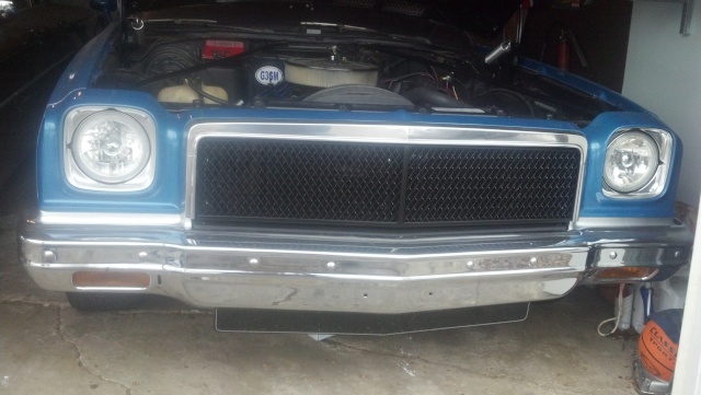

Here is what she looked like with a "blacked out" '74 grille. I changed it because I prefer the look, plus the appx 15 pound weight reduction is a big bonus.
When I got it (from another member) the grille shell was primered. Since painted wasn't the look I was going for, I stripped it down to find a typical ratty looking anodized finish. I spent a great deal of time stripping the coating down to the bare aluminum so that it could be polished. Now it shines like chrome. I also resprayed the grille itself as it was flat black, and I prefer semigloss. The only thing I am a little bummed about is my original emblems don't fit.
another view. Hopefully this year the hood will get painted, and I will paint those bumper fillers the proper blue also.

looks good Bossman, and you can dremel type grind them to fit I know this can be done

How are you prepping the little holes in the center of the grille to be painted? and how well is it sticking? I really want to paint the grille in my 73 Monte, I love the black center look!

The '76 grille is plastic. All it took was a good cleaning, a light scuffing and a few costs of satin black paint for plastic. The potmetal one in the top pic should be the same as yours. For that one I had it sandblasted to remove the chrome, primered it and painted the black ((inside and out). When it dried I masked the black to spray the aluminum silver. I used ceramic engine paint for this and it seemed to hold up pretty well to rock chips. BTW I believe I used duplicolor products.JiMi_DRiX wrote:How are you prepping the little holes in the center of the grille to be painted? and how well is it sticking? I really want to paint the grille in my 73 Monte, I love the black center look!

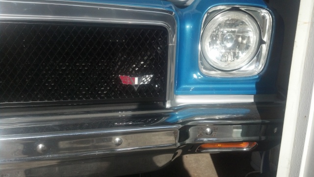

I have a '64/'67 Crossed flag emblem I was thinking of modifying to work, but idk if it would look cheesy. Sure I'll take you up on that.Limey wrote:dynchel wrote:Well thank you Paul, I appreciate that. I may be putting a different emblem in place of the chevelle emblem.

that be the one. I'm working on it right now, I'll post a pic when its mounted.

Well what do you think? I think it looks kind of cool w/o false advertising. (like putting a fake SS emblem on) BTW, I had to replace the studs and make a backing plate (aluminum of course) to make this work since it was meant to be bolted to a fender. The original application was v8 equipped chevelles, impalas, corvettes, etc from model years '64/'67. opinions...yay or gay.

It looks good to me, but I didn't hate the old one. I'd be curious as to how the emblem would look in the center.
Re: my new grille
Well I like it but centered in the other Pics I posted more, Kinda throw's the front end look off by being on the side. But its your ride if you like it there That's all that matters.

I can't put it in the center because the grille has a pretty sharp V shape in the middle, and the emblem was for fender mounting. I may put the bowtie back in the center. A '73 must have a way less sharp bend in the middle.

In my humble opinion it looks good (nice work on fitment) but maybe just a bit small compared to the "Chevelle" emblem. Didn't those badges come w/ an engine designation number like "350" in addition to having the corvette flags? Just a thought but- if you like it like it as is, that's all that matters, right?
