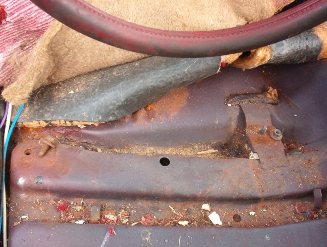

Anyway, found a photo of a '75 Cutlass Salon with std buckets showing the front floor mtg points. As you can see, there was nothing special about the inner mtg bracket (welded to the floor).
Camaro buckets into Malibu Cutlas10
Inner back mounts were just studs welded into the floor. I can maybe get a pic of that from a Regal floor pan I have.

Thanks this is a helpful photo. I'd appreciate the photo of the Regal floor too.
