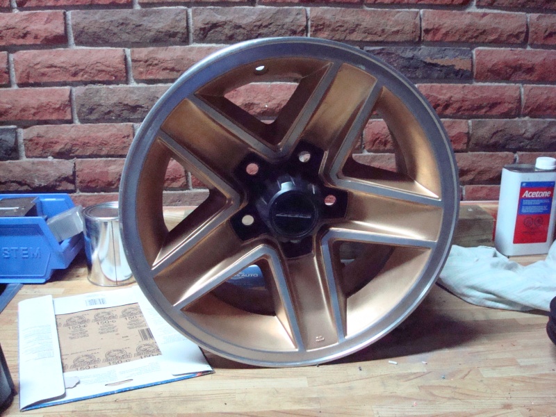

Been working on this set of early '80's Camaro rims. I figured I'd post some pics see what others had to say or add. Not to mention I knew if there was a thread it would be more motivation to get it done than to put it off.
I picked these up about 2 years ago, and have just started sanding them down. They were gold and looked great but hadn't been clear coated so not as much work as it could have been.
![Aluminum Wheels Dsc02210](https://i.servimg.com/u/f39/18/50/23/95/dsc02210.jpg)
I've got two of the four done, will be painting them glossy black, and then sand down the flats so they look like they do now, and some rattle can two part clear after that. Chrome lug nuts, and I just need to find an emblem for the centre that doesn't say "Z/28" on it. (Any ideas?)
