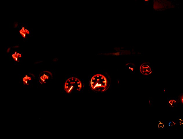

Post by thatfnthing Tue Jul 15, 2014 11:55 pm
w451973 wrote:
chevellelaguna wrote:Yup, those pesky hidden screws. This may be the time to upgrade all the bulbs to LED ones!
Has anyone here done it and how well did it improve if any at all ?
Judge the brightness for yourself.  Blurriness is due to a mediocre photographer.

Post by Joe73 Tue Jul 15, 2014 11:59 pm
I agree, no noticeable heat, definitely way less wattage. LEDs have no heat due to no filament. LED (Light emitting Diode). I converted all my 1156 bulbs in my camper to LED panels consisting of 32 LEDs in each panel. Even with just two 1156 bulbs running in my camper the blower for the heater would dim the lights upon start up. Now I can have ALL my LED lights on in there and they dont even flicker when the blower kicks on. And the LEDs are WAY brighter to boot.
