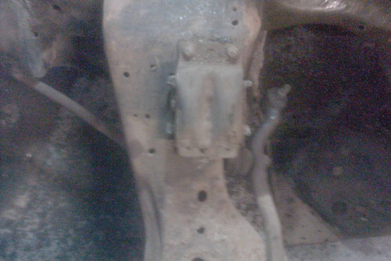

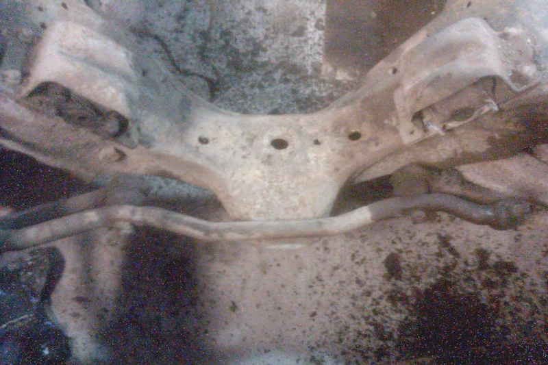

Not sure if this helps but here's a few pics of the motor mounts for my 75 SS el camino with 454 removed. Excuse the poor quality of the pics, I took them with an old cell phone. The motor mounts are different from the small block motor mounts. You'll notice the top of the mount has 2 holes where the bottom of the mount only has one. On the small block mounts there are 2 holes top and bottom.
BB vs SB motor mounts - Page 2 Motor_10
BB vs SB motor mounts - Page 2 Motor_11
BB vs SB motor mounts - Page 2 Motor_12

Those look like they're positioned just like my small block mounts on both of my frames sitting here. Also only 2 bolts on top and 1 on the bottom. Bottom front edge of the mount overhangs the frame a bit.
BB vs SB motor mounts - Page 2 Hv9xjc
BB vs SB motor mounts - Page 2 2f0d2f9
BB vs SB motor mounts - Page 2 Empty Re: BB vs SB motor mounts
Post by Dinomyte Sun Sep 07, 2014 9:19 am
They look just like mine too, positioned with the 4th hole off the frame. I had to ask if that was right when we pulled the old motor (305) out a couple of years ago.

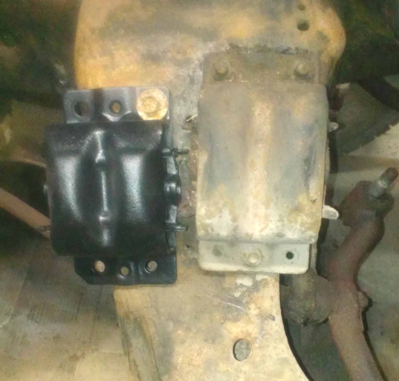

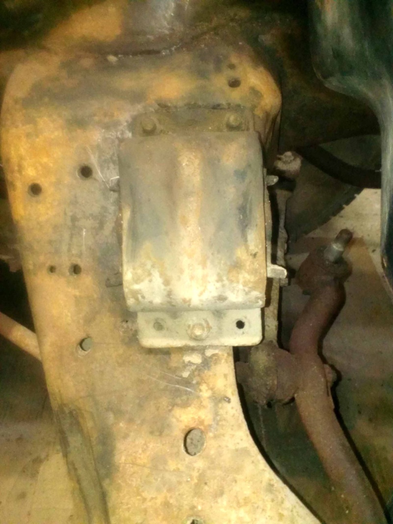

I took some better pics of my factory big block mounts and compared them to the small block mounts I have for another project. Not sure if you can tell in the pics but the big block mounts are definitely bigger by about a half inch. They also have the bolt hole in the middle of the bottom side and rivets on each corner. The small block has the rivet in the middle and bolt holes on each corner of the bottom of the mount. The top of the mounts for both look the same. Here are the pics. Hope this helps.
BB vs SB motor mounts - Page 2 Motor_13
BB vs SB motor mounts - Page 2 Motor_14
BB vs SB motor mounts - Page 2 Motor_15
BB vs SB motor mounts - Page 2 Motor_16
