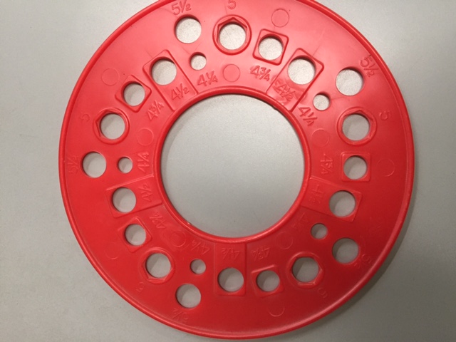

Could you use one of these and put it on the 5x5 stud and then mark your 4x3/4 holes to drill them?

Yes please on that pattern thing. What is it called and where can I get one?

Tool guy at any car show swap meet its a bolt pattern guide its less then 5 bucks.

Here ya go.
http://www.summitracing.com/parts/mfy-8021392/overview/

Really handy if you are buying rims from some one also.
