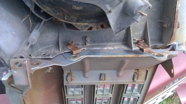

Here's a pic of the backside holding the two together. The mtg peg on the far left is the upper one and it lined up. I also noticed the contours at the top seemed to mate together well when I held them together. And yes, the '76/'77 header panel is a full panel.

Re: mix and match front and rear ends
Thanks for the effort! I can see what you mean. It will take some customizing, to get those attached to each other. Well, I will see if I can get a hold of a 76-77 header panel and try for myself. I just have a feeling the light housings are exactly the same shape and size, the only difference in appearance being the shape of the light it self.

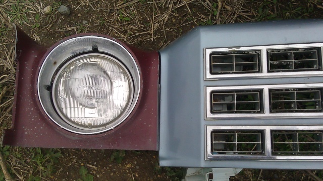

Back out there and did some further trial fitting.

Notice the bottom of the '75 headlight housing is higher than the '76 header panel? Also, second pic shows a poor fit along the sides where the two mate. I was only able to fasten the very top bolt as the other three didn't line up. Not even sure that bolt was in same exact location as the view from the top on the third pic shows uneven alignment. Still, I just got the impression these were just not mating up well together.

Wow very nice job! Thanks a lot for this!
I see what you mean about the lines not matching up perfectly. By googling a bit, it becomes clear, that the square headlights are taller than the round and the bumper filler itself is also pre- and post 76 specific.
I have doubt as to wether it would even look cool to mate a round headlight with the 3 bar grill of a 77.
