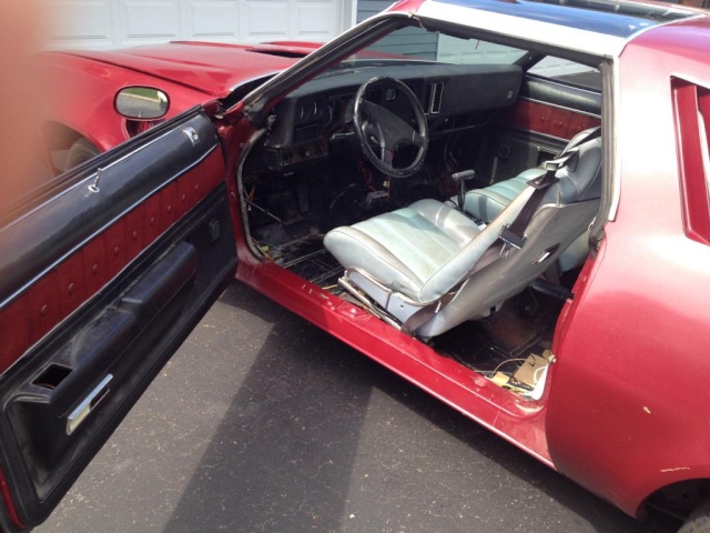

Has anyone replaced the swivel buckets on 73-77 Chevelles with any more commonly available seats?
The reason I'm asking is the swivels on my 74 are basically falling apart. The seat structure is ok, but all the foam and upholstery are shot. I just watched a vid on YouTube where PUI replaced the upholstery on swivels and said the swivels were basically the most difficult seat to reupholster of any they've done. Difficult usually means expensive.
By more commonly available, I was thinking third or 4th gen Camaro seats or even S-10 seats. Or has anyone grafted in any other available seats? From photos I've seen, you can take the swivel mechanism off the seat sliders, and you have basic bucket seat sliders.
I was in a junk yard this week and was looking at truck seats. There are tons of them at decent prices and likewise on CraigsList. But I think the truck seats are too thick.
I've looked at some generic sport seats and while they lose the originality of swivels, they do seem to be good prices.

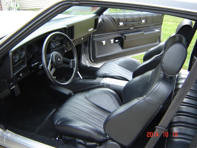

I personally do not like the swivels seats at all. I have a set here and I don't plan to use them. On my 73 I have 88 Old trofeeo seats in it. The have a power seat bases. Power lumbar and power side/lumbar. I also installed seat heaters in them for long drives in the fall. Most comfortable seats I have ever had. I have not done the head rest yet and they are low profile head rest so they wont look to out of place.
On the 74 Laguna I have these Blue Monty seats for now installed on 6 Way power seat bases. They fit good.
I plan to use these seats in the car out of a 74 Pontiac Le-mans. But like most Upholsterers are telling you I'm avoiding them like a plague as they suck to sew up and install.
Just about any 80's to even 90's Gm seat will fit. Just get it out of a two door weld a tab or two on for bolting up and your good to go. The trofeeo seats are a two door car and they have power recline also.

Everyone that has seen all of our old Monte's recall's the swivel buckets. They have had time in the era. But older I got the more uncomfortable they became not being to recline them. I myself have got to use to sitting in modern comfortable seating. I sold the swivels...for more than I ever expected to get .....then applied towards the purchase of the Procar's. I was out for much less than the price of seat covers.
Dimensionally , they are a fit. Just as if the factory put them there !!
