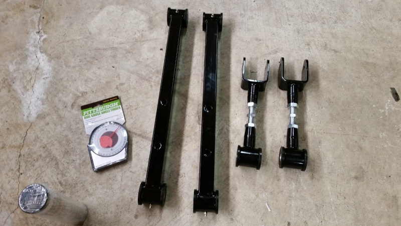

I have a set of poly bushings from Energy Suspension I just bought. I used the dif bushings and then decided to go with new arms that had bushings in them. I paid $83 for the set. $50.00 shipped buys the rest.

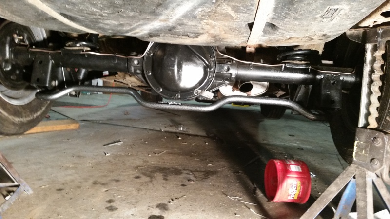

I am hoping this make that much difference.  These cars had that mushy floaty feel when they were new.  Hopefully with the 2" lowering springs front and rear, 3.73 gears and 1-1/8 sway bars front and rear it will handle like it should.  These are Spohn arms.

That will help...my setup is similar.

Oh it will handle nice. I've read on a couple of forums on how much better the 73-77 A body suspension geometry is a big improvement over the 64-72 in the handling area.

You will love the way it will feel now. It was a night and day difference in mine. I have basically the same set up and gears as you do.
