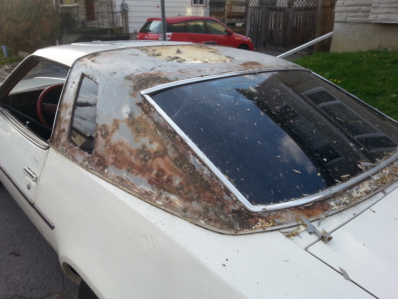

Unfortunately, you won't know until you remove the vinyl top. I removed mine and surprisingly, it was not that bad. When they put these on back in the day they used a vinyl with a "built in" backing pad. The entire thickness is about 1/8". They used adhesive over the paint to bond the vinyl top to the roof so eventually that will fail. The worst of it should be around & near all the trim pieces where water/humidity collects.
Re: Erichs 76' Laguna - White devil.
Ya i dont have a choice i think. Saturday it rains big and if it gets under and pools up im screwed. So i need to tear it , scrape it. Sand it. Prime and paint temperarily to save the car
wunderlich_33- G3GM Member
Be careful & very patient. If you're lucky you can peel it off with the help of a plastic putty knife to where you can get it down to the "hairs" where the backing is stuck to the paint. Don't pull too hard or you might take up paint & primer both, then you'll have to use filler. The trim piece around the back glass where it meets the body panel before the deck-lid might have to be unsecured from inside the truck (not sure on you're car mine was secured with two little nuts).

Hey! It doesn't look that bad!
Any rust through?
Any rust through?
Looks mostly like mold/mildew, hopefully.
no rust going all the way through. some real bad pitting in some areas, and the whole padding inside the vinyl was soaked

Never cool to have any issues but glad you were able to catch it before anything ate through the metal, which would have been more time and money.

That dosent look like the original grain on the vinyl so I dont think you lost your original top. Its a blessing in disguise because now you can clean it up real good before you put the top back on.

Yeah im really starting to believe that the vinyl was an after thought by the original owner when he installed the sun roof.
but now I have to drill out all the rivets (cause that was a smart way to attach trim ) and then get the little pieces of vinyl as best I can cause its not like I can remove everything. I don't even have a garage so im doing all this in the middle of the street.
if I can get the pits filled and it sanded and primed for Friday ill be safe, but its gonna be close.
ive never done body work in my life. I just reaqlly hope it doesn't come out looking like garbage for the next how many years till I can get a body job or a garage.
gotta say though im learning quite a bit about my car, cause I had to take the interior apart to get at the screws for the loovers. but on of the screw in needs to be repaired now cause it snapped, not too badly.

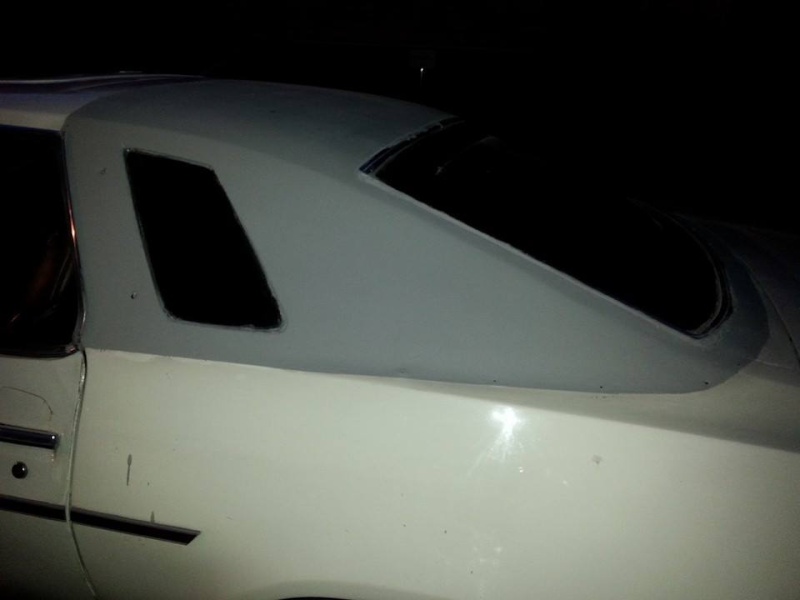

im not planning on putting on vinyl again. too many problems down the road, like right now..
I was gonna remove it eventually I just was thinking in the next 2-5 years or so when the whole body got done. I just wasn't ready or prepared for it. hell of an improve on my part,

On the upside, the 75-76 Laguna looks good without the vinyl. The louvers make up for it.
You'll find that the filling and sanding isn't that hard, just time consuming. You might even enjoy yourself.

Yesh I find without it it looks far more likea muscle car and like less of a cruiser.
oh don't get me wrong, I love working on my car, and wood working and plastic work is what I do for a living and I love it. its the rushed feeling/ time constraints that make it stressful.

Just make sure you get a good rust neutralizer on there before you use any filler or glaze or anything. You dont want it coming back.
yeah the whole process was:
sanding
2 coats of rust inhibitor
body filler
lots of sanding
3 coats of grey primer
sanding
body filler
lots of sanding

I'll give you credit for knockin' it out that quick.

If im backed into a corner like with the weather coming im not opposed to putting in an 8 hour day on the car. id rather take my time but just didn't have it,
sadly I must say.... you can tell it was rushed. and the 1/4 holes from the trim need to be welded but they quoted me $1000, so for now the wholes are blocked off with small pieces of waterproof aluminum tape till I can get her in sometime before summers over.
