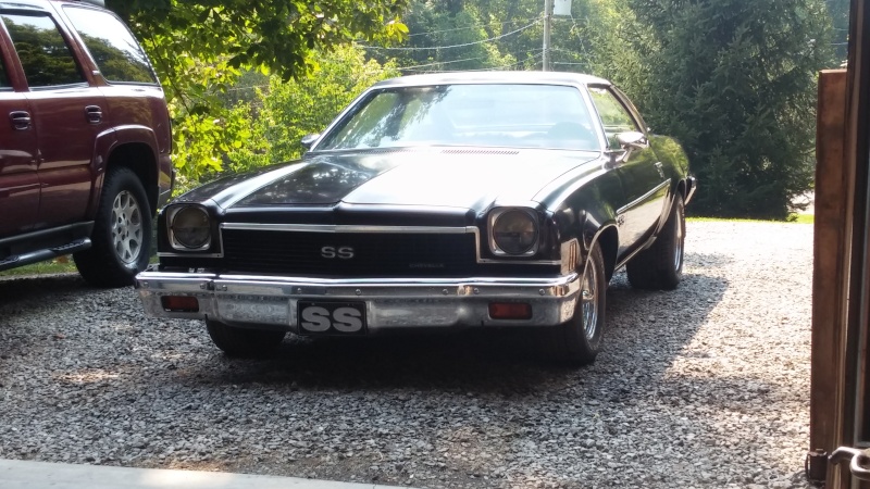

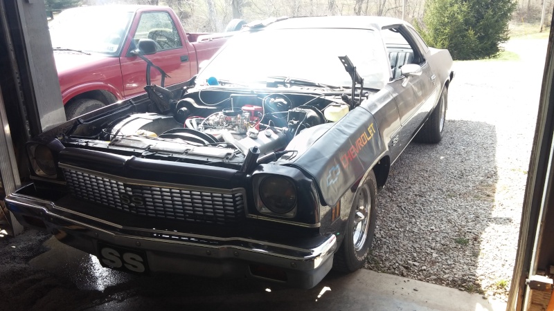

It's been a few years, but I am finally making a little progress on the '73 coupe. The 427 is built, installed and running. Doug Thorley headers and Summit racing dual exhaust installed. Rebuilt 350TH transmission with B&M shift kit and 2000 stall converter. I know the trans probably won't live long behind the big block, but it's what I had and this is a very tight budget build so I'm rolling the dice.

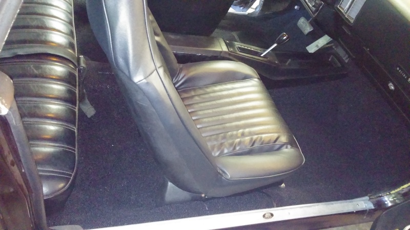

Also got the new carpet and front seat covers installed. I'm happy with the car so far. I wish I had the money and time to do a full body off resto-mod on the car because it is a VERY straight and clean body (especially being in WV and Ohio it's entire life) with 100% of it's ORIGINAL sheet metal and very little rust. I'd love to know what you all think. Here are some pictures.

As far as the Trans, consider a separate cooler just for Trans fluid. A TH350 is built pretty strong, the enemy is overheating the fluid, not necessarily the new motor/converter combo.

Lookin' good !! The TH350 is actually a fairly strong transmission, and a shift kit puts more servo pressure on those clutches, which seems to make them hold up better.

Thanks guys. Pontichev327 it is supposedly a dark cherry metallic from Oldsmobile. Previous owner told me it was a 1986 Cutlass color. It is burgandy basically, I hate it, but they did a decent job painting it. As for the transmission, I do have an auxiliary cooler for it, but I sincerely don't think it will withstand the big block's torque. I have a 4L60E as well as a New venture gear 5 speed one of which might find it's way in the car eventually if I decide to keep it. Hopefully I can get it outside and clean it up this weekend. Can't wait to drive it!

I wouldn't be afraid of the t-350. The 427 is not a torque monster with its short stroke and a t-350 can be mildly modified and handle 600 hp with no issues. You're probably going to have traction issues long before torque damages the trans. Now if you were trying to dead hook it at the track with slicks, then you may burn up some clutches.

Clanceman427, it does have one little spot of rust about the size of a nickle on the edge of the right inside tail light. I repaired two spots the size of a quarter in the floor pans while I was replacing the interior. Other than that the entire car is straight and clean. I already added a shift kit when I rebuilt the TH350 also red clutches and kevlar band. The cam is a Comp cams off the shelf grind with 491 lift 268° duration and 110° lobe separation. The block is bored .060 over and the heads are the mid level 119cc combustion chambers. The compression ratio is 10.6:1 if I did my calculations right when I ordered the pistons. I have not even looked at the rear axle or drove the car yet. I do have a 8.5" locker with 3.73:1 gears and disk brakes if/when the time comes. Also have an Impala ss rear sway bar and close ratio steering gear for it.

Got it outside and washed today. I'm happy with the stance.
lastcoupe- G3GM Newbie
Re: '73 Chevelle coupe progress
Agreed, that looks really good!
