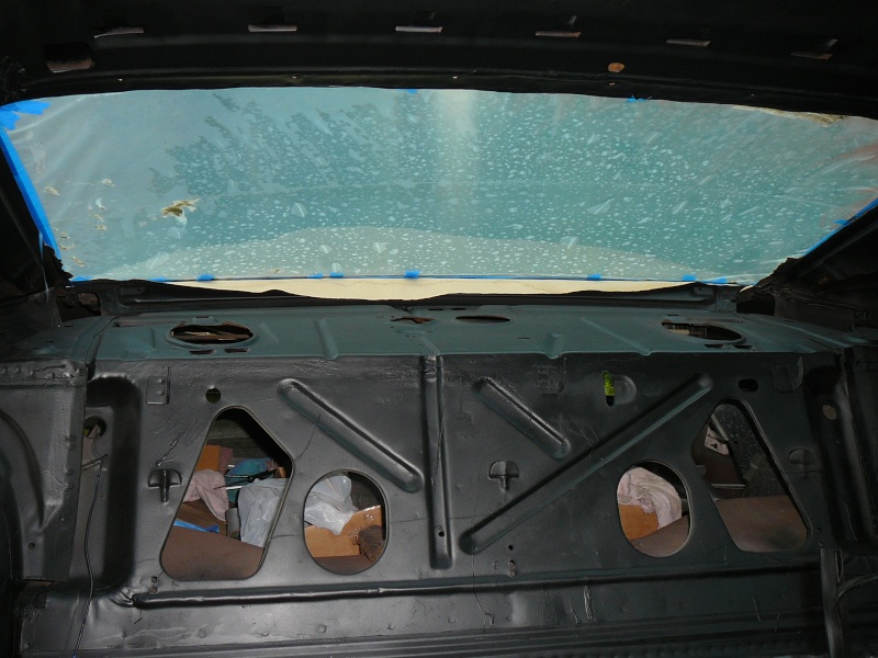

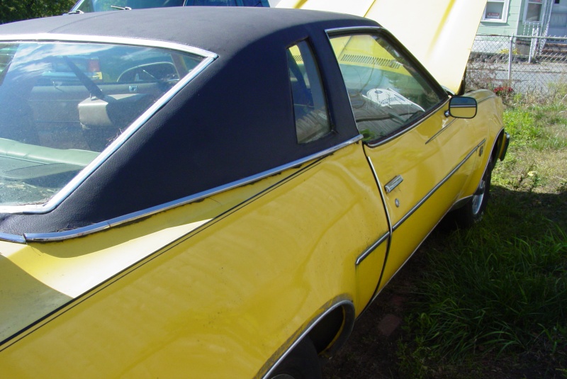

I picked up Mali last November up in NH. Found her on craigslist after hunting for over 2 years on every type of internet site available for classic cars. I new she was the one because she was solid, about 97% complete and most importantly, we could afford her! This project has been not only a reconnect with classic cars (that I've always loved) but restoring a car, to me, is the best therapy money can buy. Everyone needs a hobby to escape the day to day grind and old Mali has given me a chance to step out of my comfort zone and take on a different challenge. I will be posting progress pics here in the future for various things but I wanted to start with one of the first major challenges: Removal of 2 vinyl tops and the subsequent repair and restoration of the roof and surrounding body areas. All in all, I was pretty lucky there was no real "cancer" eating away at her. Another year out in the elements and it might have been a different story. Those studs are all ground down. She will not be getting a new vinyl roof covering.
Here you can see the 30+ year old adhesive residue and the two tops. Look close cause the old "saddle" colored one looks like the adhesive!
1977 Chevelle Malibu Classic Progress Photo's aka Mali Dsc01711
1977 Chevelle Malibu Classic Progress Photo's aka Mali Dsc01712
It's funny that the cleanest part of the roof was the center-line where the original top was stitched in the middle and where no adhesive was used!

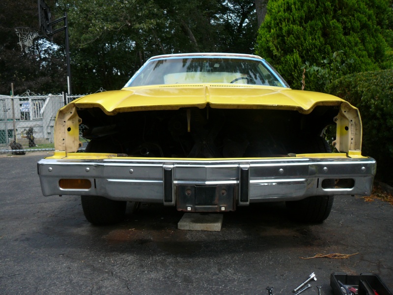

The "After"...1st coat was today...will wet sand and put on another coat of primer (Maybe 2 depending on how the wet sanding goes).

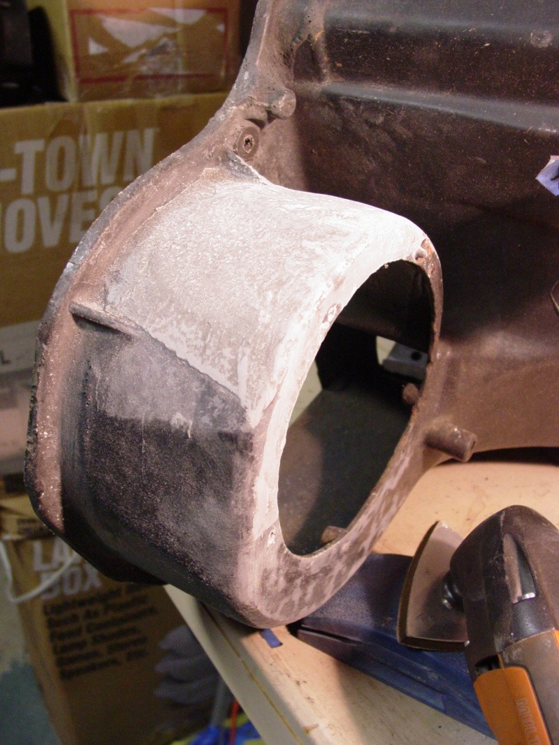

The heater box and or A/C box (can't remember if one or both) bolt to both inside the car and in the engine, it;s a pain on the neck but if you're careful not a big deal. I will say that my pass side inner fender is off the car and that will make it easier to access some of the bolts. Here is a pic w. the stuff off.
1977 Chevelle Malibu Classic Progress Photo's aka Mali Dsc01518
My heater box was in good shape the A/C box in the engine compartment needed work though. I took that out and used the green Bondo w/ the short fibers to patch it and then used Duplicolor for plastic in black, came out good. I did remove the small amount of rust scale on both this box and the Heater box door.
1977 Chevelle Malibu Classic Progress Photo's aka Mali Dsc01412
1977 Chevelle Malibu Classic Progress Photo's aka Mali Dsc01413
1977 Chevelle Malibu Classic Progress Photo's aka Mali Dsc01513
1977 Chevelle Malibu Classic Progress Photo's aka Mali Dsc01514
Using my drop light to heat the bondo...was a cold day in the workshop.
1977 Chevelle Malibu Classic Progress Photo's aka Mali Dsc01515
1977 Chevelle Malibu Classic Progress Photo's aka Mali Dsc01516
1977 Chevelle Malibu Classic Progress Photo's aka Mali Dsc01517
The end result. Heater motor hidden, sorry. Gotta have some secrets! Used red High Temp RTV Silicone to seal the two pieces & around the blower motor also.

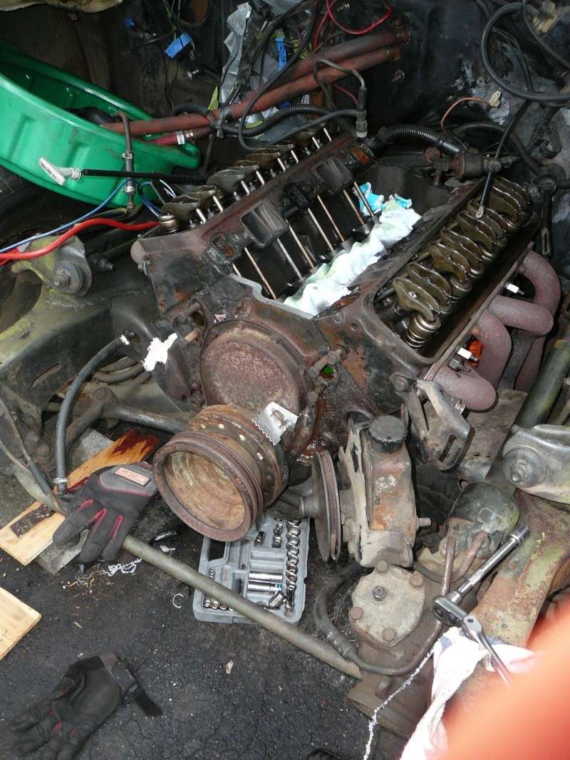

Well since last time I've made the decision to disassemble the engine and have the lower end components evaluated locally. I think it's a head gasket at best and possibly in addition a bad set of rings on two cylinders on the even side of the block. We'll go from there & hopefully will have it up to them in a couple of weeks. Thus far the entire front assembly minus the bumper is off the car. Radiator, radiator/condenser housing, fan, alternator, pulleys, belts, water pump, carb..etc...now cataloging all the pics for reassembly. Oh what fun. Here she is without her "teeth". Most parts are still worth restoring too which is good!

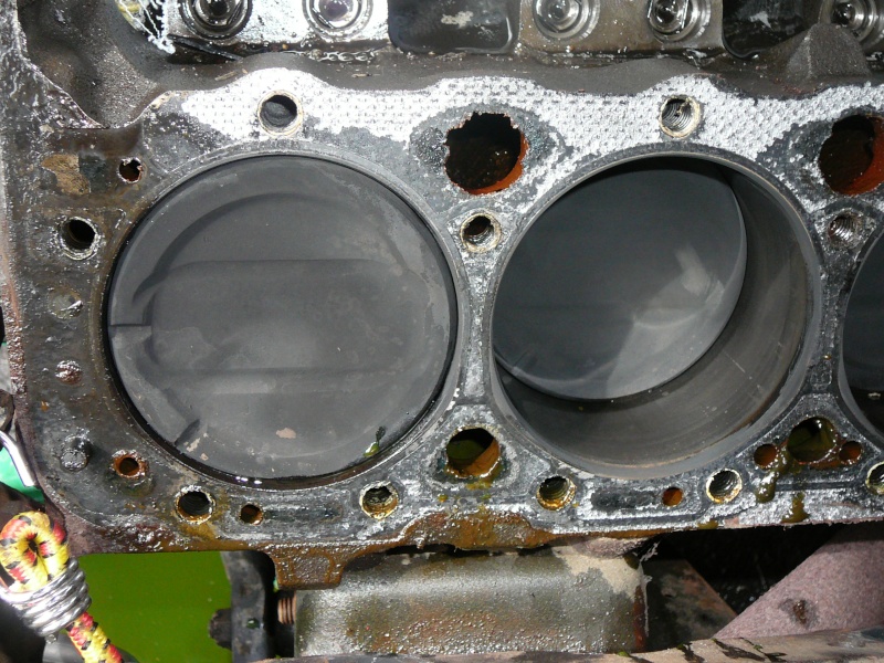

Post by pila Tue Sep 06, 2011 11:13 pm
Looks like you have a lot of clean-up to do on your engine installation. How many miles on the engine ?
Maybe the cylinder bores will accept a ridge ream, a honing, & new rings. Problem there is, cleaning the ring grooves on the pistons etc. Pain in the butt...
Got a ball-park figure on how much you can spend on the engine?
1977 Chevelle Malibu Classic Progress Photo's aka Mali Empty Re: 1977 Chevelle Malibu Classic Progress Photo's aka Mali
Post by 77mali Tue Sep 06, 2011 11:20 pm
Have a great shop up here to do all that. If needed will have them rebuild & balance the bottom end. With all that needs to be done to get her on the road...my time is at a premium. Would rather have it blueprinted & done up right. No idea how many miles on the engine, the body has 134k but engine is not the original 305.

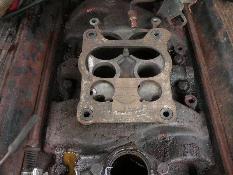

Post by 77mali Thu Sep 08, 2011 5:49 pm
So I spoke to my engine shop & they did confirm that the heads are from a 305 but block is a 350 5.7 L. Going to swap heads for some 23 degree Vortec & will have to get new intake too as the old one will no longer work. Have not pulled the heads yet but will look at the cylinder walls once I do that to be sure there is no issues w/ the pistons & rings. I sent him this pic and he said by looking at it it was probably a low mileage engine that I should reuse w/ the better heads. Should make from 320-340 HP. Not to shabby for just cruising LOL just gotta remove all the grime & rust from the thing sitting. Wish me luck though!
1977 Chevelle Malibu Classic Progress Photo's aka Mali P1010210
Edit- sent him this pic....prior to covering the oil galleries...

Post by Fishgrinder Thu Sep 08, 2011 6:26 pm
The galleries do look clean! To late to turn around now Mali, keep up the good work Wink

pila wrote:Looks like you have a lot of clean-up to do on your engine installation. How many miles on the engine ?

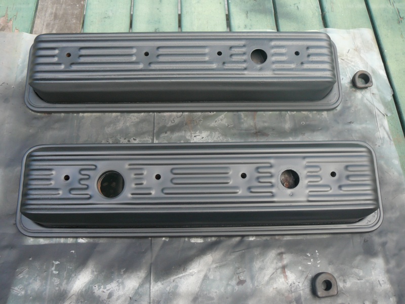

Heads/Intake/Gaskets approx 1K. (better than a total rebuild I suppose or crate motor).
Reusing the rocker covers too...clean up & paint to save some $$.
1977 Chevelle Malibu Classic Progress Photo's aka Mali P1010412
Not perfect but will do for now.
