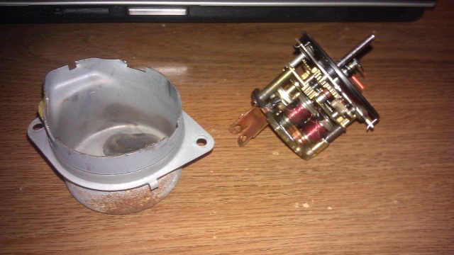

![i might need my clock cleaned! Innerc10](https://i.servimg.com/u/f35/15/48/55/09/innerc10.jpg)
Yep..sounds like it just needs a little lubrication. I've pulled apart dozens of these and probably half of them just need some spray on the inner workings (other half have burnt coils). Pull the hands, lift the three tabs around the edge of the clock face and lift up on the face. It won't come off all the way as the set knob shaft will hold it back at the base. But, it lifts enough to access 4-5 crimped tabs on the top of the housing. I usually go further with disassembly and loosen those tabs and that allows total removal of the insides...but, this may not be necessary if your's still shows signs of life. Just spray inside and you should be good to go.

Mcsrlo77; thank you! Very helpful guidance and picture, I would not have known all that. Much appreciated!

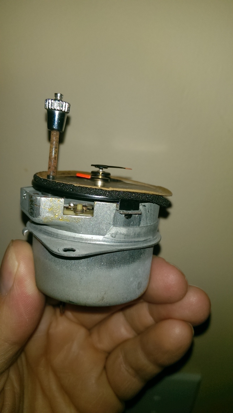

I got the 3 tabs bent back and the face is ready to come off, but how do you pull the hands? I tried to lift the second hand but met resistance so I stopped. Is there a trick to pulling the hands? I didn't want to break anything.![i might need my clock cleaned! Imag1414](https://i.servimg.com/u/f35/19/28/02/70/imag1414.jpg)

It can be a little stubborn. I have a small tack puller that makes it easier to straddle the center shaft and pull upwards with a steady pressure while gently wiggling it back and forth. It helps keep even pressure at the center so you don't bend the hand. But, it will come straight off. Minute and hour hands just slide over the center peg and are easy to remove.
After thinking about this a little more, I'm not sure you'll be able to get to all the critical inner workings with spray lube without removing the housing plate just beneath the face plate. As I mentioned, there are several spots along the edge where it's crimped over to secure the inside assembly. Need to bend those straight to allow separation. At that point, I push up on the electrical prongs on the bottom to help unseat it.

You're the man! Looks clean inside. Should last a long time if kept lubricated periodically. Biggest reason they burn out is that the "works" get dirty to the point where the two electrical contacts that snap apart when they touch during the unwind/rewind process don't...and, the prolonged electrical current burns out the coil windings.
