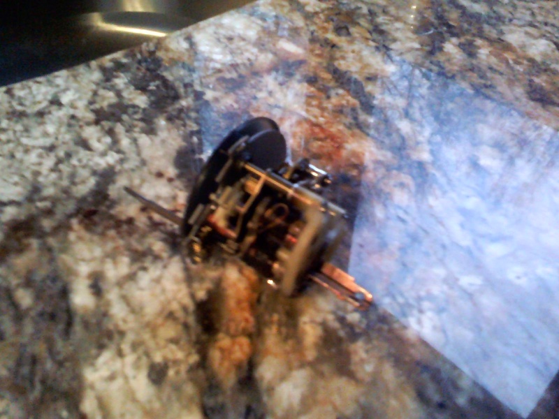

Regarding the clocks we have in these '73 thru '77's, round ones for the gauge package, looked around and not able to find anyone who retrofits a quartz replacement for these?
I have a nice quartz replacement in my '72 that works great. We could send these clocks out to have them worked by some specialists but they will end up failing in the future so the quartz replacement seems to be the real answer here.
Two questions?
  1. Has anyone found any quartz replacements for these clocks? I have looked around and found NONE!
  2. If there was a quartz replacement, would you spend ~$150 for one? How many of you are out there that would spend that much for a GOOD QUARTZ replacement?
I might have a supplier that makes them for other applications and would make them up for this application, just trying to see if it is feasible and what the market might be?

I have 3 stock clocks and have taken them apart and repaired them my self. Don't just spray lube in there though. The mechanism uses a real short winding cycle. As, the clock operates the spring slowly unwinds moving two "points" together. They make contact 12v is sent to a repla inside and it starts the whole process over again. These points get dirty or burned just like standard points in a distributor do. If you are real careful you can use a jewelers file and flatten and clean up the contacts. takes pictures as you disassemble as there is a spring that can be lost when you take the cover off. Lift it off slowly. Spray all down w/lighter fluid or contact cleaner. Use a pin or tooth pic to oil the ends of each pinion shaft you see. Put it back and test. If it is ok you'll see or hear the contacts and the snap back they make. Mine is running fine for the 8 months no problems. If it's already broke you can't hurt it and you might just fix it. They are crazy to buy working. $100 plus...
