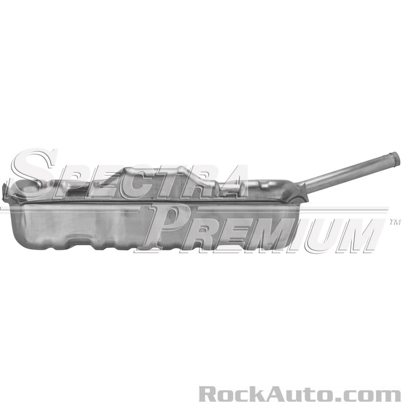

It's weird that Rockauto doesn't show a fuel sending unit for El Camino. But, there's no reason to believe that it would be any different than on the coupes.

Mcarlo77 wrote:It's weird that Rockauto doesn't show a fuel sending unit for El Camino. But, there's no reason to believe that it would be any different than on the coupes.
Yes, that is strange. That's why I am asking. Fuel tanks seems to be not the same shape and dimensions according to photos and rockauto numbers, so the height of sender unit can be different too
