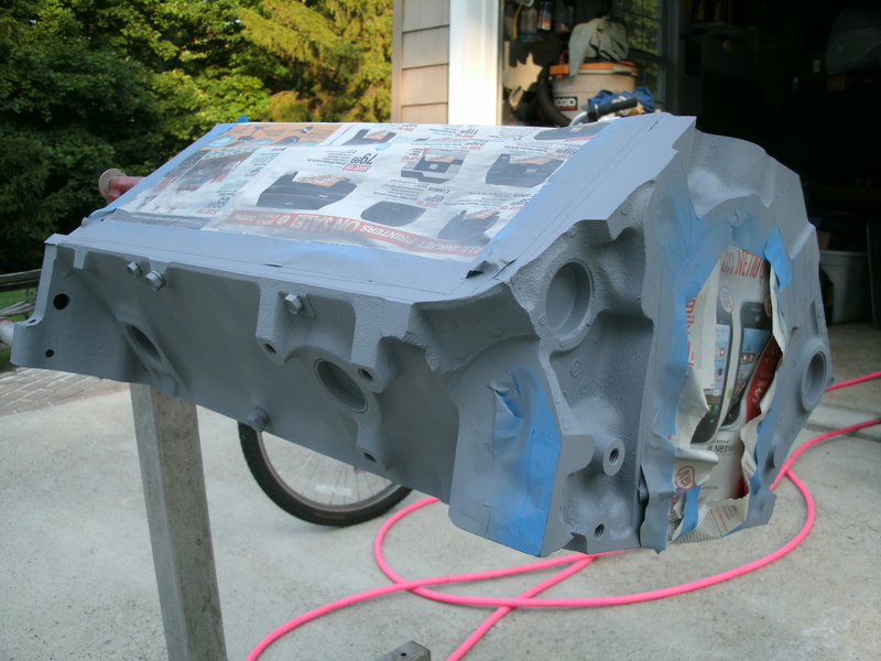

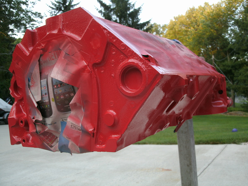

Post by Joe73 Mon Jul 17, 2017 4:39 pm
I got mine back from hot tanking and then I taped it off and sandblasted it.  Then high temp chevy orange red.

Kevin. I first scrub the block down with lacquer thinner and wire brushes. Then I like to soak the block and lightly scrub with wax and grease remover. Install the freeze out plugs with some Indian Head (old school) sealant.
Then I used spray cans taking my time to put it on a little wet. I didnt want any dry spray. I used Dupli-color 1612 high temp primer just to cover, not heavy. Then I used Dupli-color 1607 Chevy Orange-Red. From the research I've done, that is the correct color for a small block in our years and prior. The big blocks had a slightly different color and I believe it was a Red-orange but I'm not sure about that.
Lots of people have great results shooting regular basecoat on their engines. Guys say it holds up great. I thought of shooting epoxy primer because I use it on everything. But I've always had good results with Dupli-color high temp paint so I decided to stick with it.

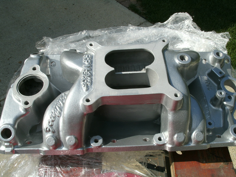

I agree !!  Even though I'd love to clear coat them.  LOL.  I powdercoated my rpm air gap.  I know it will hurt heat dissipation but I cant stand the look of a dirty aluminum manifold.  I did my scattershield as well.
