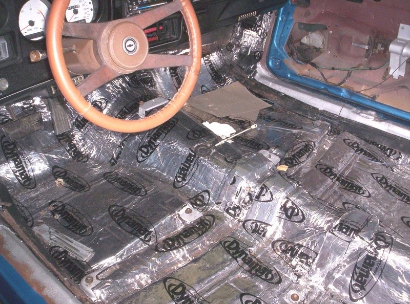

When I replaced my carpet I just cut x's where the bolts come through. I didn't think it was necessary to cut the carpet open to install the console. I did however cut out a rectangle for the front console mounting bracket. Here's some pics for reference.

I did much the same as g3chevy, when I put my carpet in. X's where the bolts go, and just cut flaps around the console brackets to expose them, I think the front one I actually tucked the carpet under it, just because I could. The shifter and cable have yet to go in but they'll get the same treatment. Sorry can't find pictures.

Ok, turns out with a little direction from you guys the console install was pretty easy. I just cut flaps like was suggested. One last detail and this job will be done and I can post pics. When I reinstall the rear seat lower seat cushion, do the lower "loops" sit on top of the carpet and the bolts with large washers go through the carpet?
