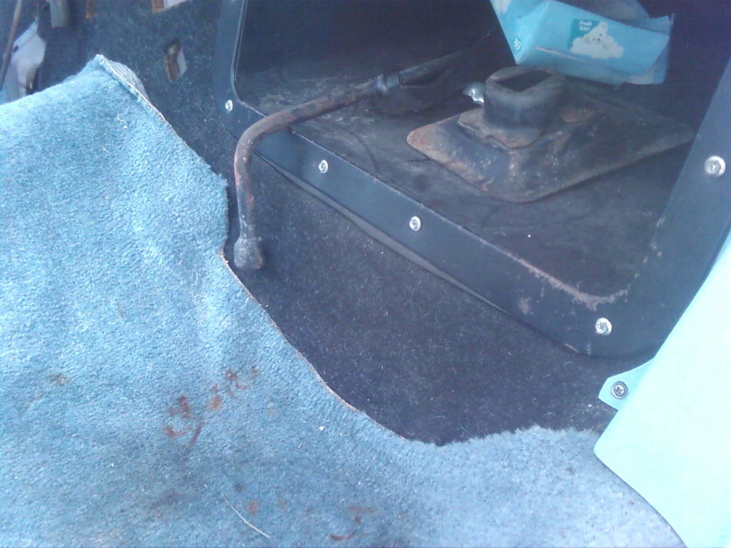

Joe, I spoke with an ACC rep via email before I bought carpet for my 87 El Camino to clarify what they were calling "mass backing". The carpet I pulled out had the mass backing on it which is a rubberized coating that is applied directly to the back of the carpet and then the jute backing is attached. I just went with the jute backing and used Dynamat on the floor pans. It's actually quieter and cooler inside the vehicle now. So I think the mass backing would be overkill if you use a sound deadener like Dynamat. Here's a pic of the carpet I pulled out for reference. Hope this helps.

g3chevy / Mr Pontiac wrote:Joe, I spoke with an ACC rep via email before I bought carpet for my 87 El Camino to clarify what they were calling "mass backing". The carpet I pulled out had the mass backing on it which is a rubberized coating that is applied directly to the back of the carpet and then the jute backing is attached. I just went with the jute backing and used Dynamat on the floor pans. It's actually quieter and cooler inside the vehicle now. So I think the mass backing would be overkill if you use a sound deadener like Dynamat. Here's a pic of the carpet I pulled out for reference. Hope this helps.
I have heard the same from the square body guys - pass on the "mass backing" and go with sound deadener.
