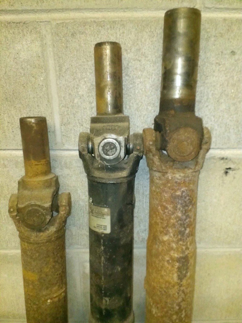

Yes, you can change the tailshaft bushing without removing the transmission. But you will need a special bushing driver to remove and install the new one. I'm sure a local transmission shop can replace it for a small fee. Here are a couple of pictures to reference of several short yoke driveshafts. Hope this helps.
