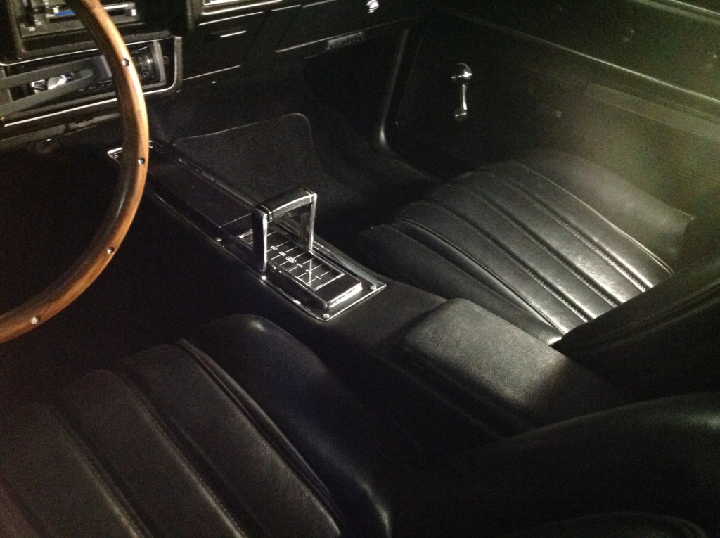

![center console Image32](https://i.servimg.com/u/f85/18/91/26/64/image32.jpg)
![center console Image31](https://i.servimg.com/u/f85/18/91/26/64/image31.jpg)
I did a conversion on my chevelle from steering column to floorshift. The 70-72 console will work but i thought i did not look good. I looked out off place sort off. So i cut the backend off and sides. I used thin mdf board and made sides and a backend. I screwed it all together and had a guy put Black later on it. It Came out Nice i Think. The top part is a camaro lid and insert rest is 71 montecarlo wich is the same as chevelle

Of course there is light and cupholders in the room under the lid. And getting the shifter to work with the trans and wiring was not to bad. Just make sure you Get the neutral switch assembly with the shifter and the wiring that goes with it, then its pretty much plug and play.
