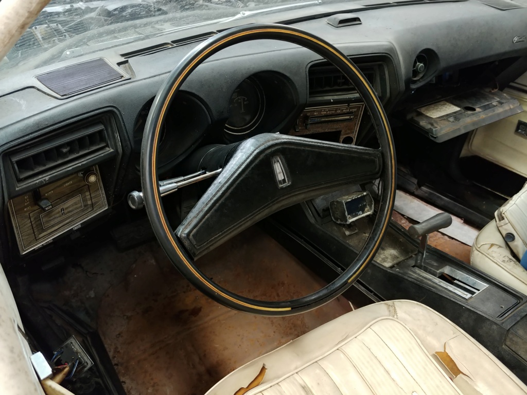

Finally got around to documenting some of the stuff on this 75 Hurst I picked up over the summer. This is a numbers matching 1975 Hurst Olds W-30 (455/400) that was found by a good friend of mine on the east side of Houston just a few miles from his house. It's in pretty rough shape but well worth sinking some money into. Been working on a few mechanical issues as well as maintenance (tune-up, fluid changes, etc.) and now it runs and drives real nice. Next phase is body work, or should I say, rust removal...and lots of it. I'll post pics and videos as I move along if there is any interest. Hope to get feedback from everyone on the projects I tackle moving forward as this is a learning curve for me since I'm a Chevy guy.
