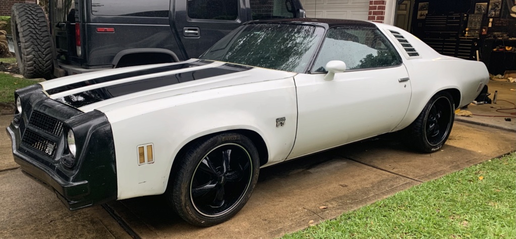

That looks pretty solid. Can you post a couple of pictures from the front and the back? Post a picture of the 454. You have a good car to work on. Let’s get this thing back on the road.
- Street Cred : 19
Re: 75 Malibu Digger build
This picture shows two valve springs, one single coil and one single with damper. Singles are consistent on all exhaust valves. Single damper on all intake. Neither spear to be the Comp Cam 924-16. I found zero springs where the manufacturer suggests two separate spring types. However, informally the odd builder out there feels they know more and put in two different weight of springs. General consensus seems to be “Why?” But also they should not directly hurt engine.

Sway bars - I can’t find any used T/A or Impala sway bars around here. I think I will keep the stick one up front for now and install a rear. I assume beefier is better? I have found a 1.5 inch steel anti sway bar comes with instal pieces, bushings etc.
Digger- G3GM Member
Anybody put in lowering springs?
My rear wheel well sits at 26.5 inches. Springs worn and shocks doing very little.
Front wheel well sits at 28 inches, springs feel
Okay but shocks poor.
I could just do the rear, see how it turns out as far as ride hieght. Or I could do everything all round to even everything out again. I’m considering lowering springs 1.5 inch.

Hey. When you post you will have 4 tabs on the top right of the post. One of them says edit. Click on that and you can edit your post or delete pictures.
By the way, I have all Global West suspension on my car with a big block. I think it sits pretty good. Some guys on here have part numbers for some Moog springs that also lower the car. My shocks are pretty expensive, Viking brand, but just some good stock replacement ones would be a great upgrade. Keep up the good work!
- Street Cred : 19
Your ride hieght looks great. I prefer the lowered look today over the old muscle car
High in the rear end. Just my preference. So Kevin it the Global West a 2 inch or 1.5 lowering spring? They don’t look too difficult to install but those are famous last words.
