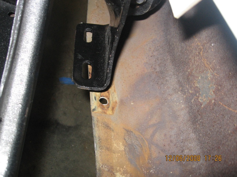

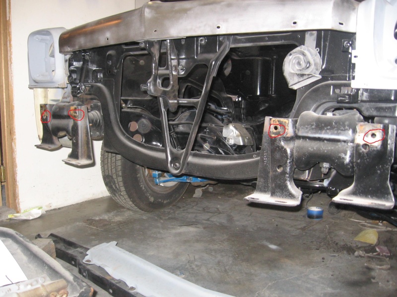

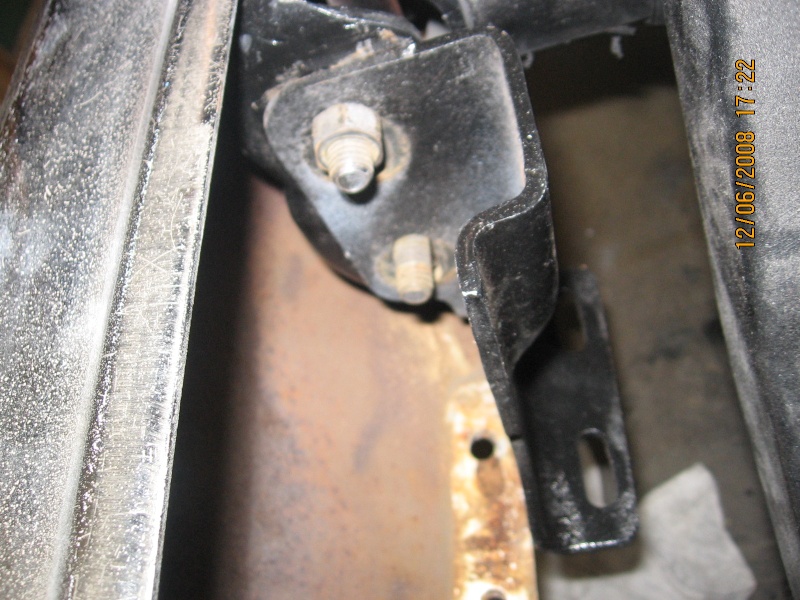

can you show a picture of the way its mounted?
i get close to getting it too fit but it just wont fit on there now, did you have to grind the top of the brackets to let the long bumper support that the (chrome attaches to) sit properly down to get the holes to line up?
Re: bumper sink in
did you leave the bolts loose for where they attach to the shocks? Cause they have an up and down adjustment. Ill try and get pics ASAP

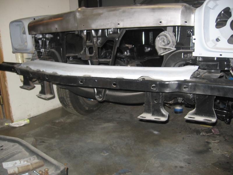

ok now this is pissing me off and theres another dent in the bumper
and some bloody knuckles, brused feet and knees, keeps falling off, anyways, i have tried it all and there is always something that wont work it wont go over the shock mount cuz of the way they go up on the ends its just an inch to far out to get it to work. only thing i can think of is to gring the top of the shock mounts flat?

Post a pic of how you have the brackets and what your having a problem with. I couldnt get a good pic of ours
BlackChevelleSS- Management

with just the chrome on it wont go on far enough at all
BUT this is with the plastic under it still and the is too much of a gap about an inch up and a inch to far back

i was thinking about grinding the bottom of the brackets to conture with the bumper inside then cutting the holes out a little further where the bracket attaches to the shocks so i can move it down more and a small cut in the same holes going toward the front of the car to move the bracket more toward the bumper so it can line up.
Re: bumper sink in
Are those the brackets that were closer to the radiator? or the ones closest to the parking lights? The ones that were right behind the parking lights were to be discarded. The ones closest to the radiator were to swap sides as meaning passenger and drivers side. There will be no brackets behind the parking lights.

hay corey instead of having two bolts like in the picture use only the top one i guarantee that will fix your problem i only got four bolts holding my bumper on and it works fine till i fab up some custom brackets
