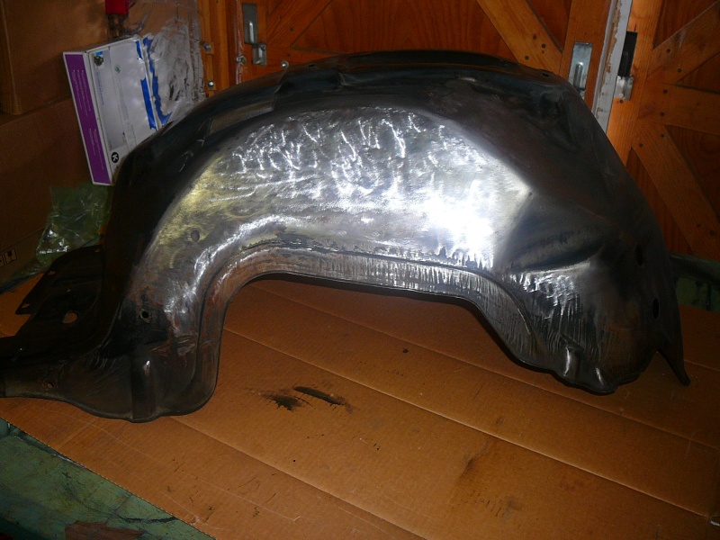

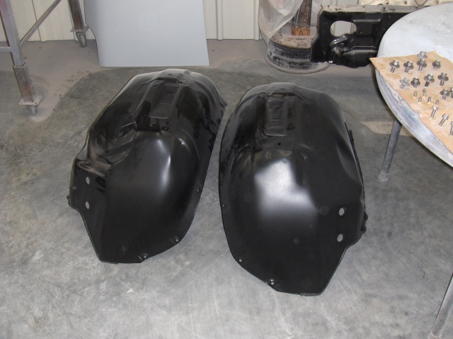

Wow...it's been a while but I did some work recently! Inner fender wells....75% there. Using POR 15 (again) will be followed by a repair to a mount hole for under the battery tray of course & then primer & paint. Anyone suggest a good primer color to put under black so it won't take as much to cover the primer? (I was thinking dark gray or brown?)
Re: 1977 Chevelle Malibu Classic Progress Photo's aka Mali
After Por 15...one is almost complete just the underside to finish. Used JB "Stick" epoxy to form the missing/corroded lip that bolts to frame by the coolant overflow res that the batt tray rests over. I was very happy with it and it used about 1/2 the stick so a $2.50 repair. Sanded it smooth- still needs the bolt hole drilled but the stuff was amazing. Rock hard/sandable within 10 minutes.
Has anyone used the "textured or rubberized" undercoating on the wheel well? I'm debating leaving it smooth but am afraid of chipping down the line...

Very nice progress. As far as under inner fenders I had mine Rhino lined. More durable and cuts down on road noise a little more. By the way be careful with the Hooker ceramic headers. I tried 2 pairs and they did not fit. They told me my frame must be bent. I wound up using another companies ceramic coated but I'm drawing a blank but I'll let you know after checkin receipts.

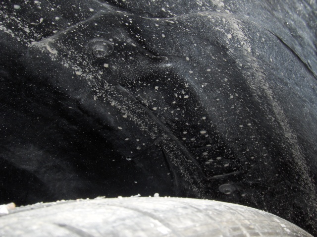

Kinda hard to see but here they are. Engine side blasted primed and trim blacked. Tire side is Rhino lined smoother than a pickup box and then UV sprayed for easier cleaning.

Thanks Budman- they look good. I'm going to try it out while mine are still off the car. That looks like a nice tight grain like they did it at GM did you roll it on or spray it?
No i took it to Rhino Lining. It is a franchise like Line-x or many other ones out there. They normally do spray in pickup bed liners. I had them do the whole underside of my body before I put it on the frame. The underside looks just like the fender wells. Should cut way down on the road noise between that on the B-Quiet I put inside the car.

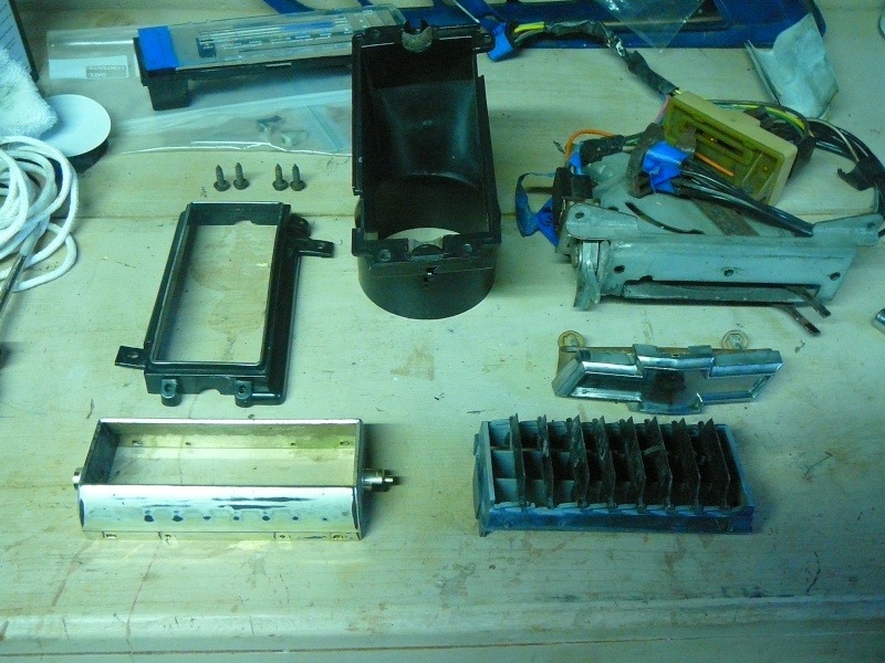

My "New" Old Dash from a 73 Monte donor (had it since last summer) just now refurbishing. Going w/ a Dash Cap that I ordered. Will post more before & after pics when it's completed. Will be fixing the HVAC face plate, blacking-out the chrome on the vents, swapping out the idiot light gauge cluster for a working gauge & tach unit & removing the wood grain veneer....Giggity.....

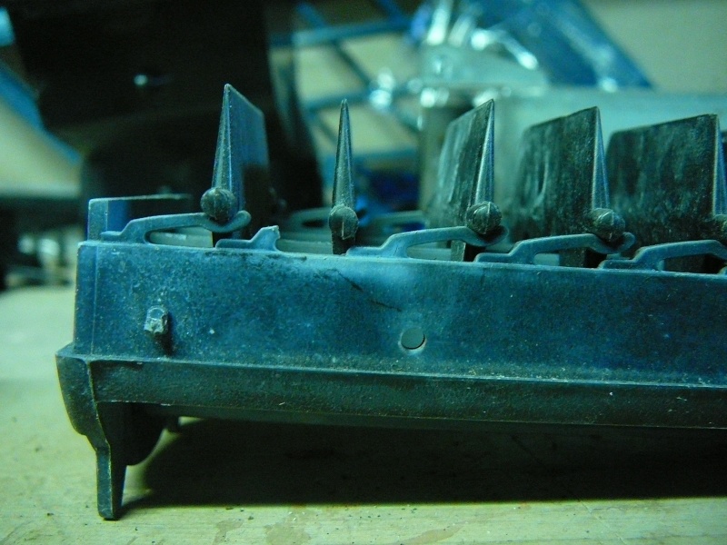

Passengers side vent repair:
Vent Shutters broken support bracket:
Support bracket repaired:

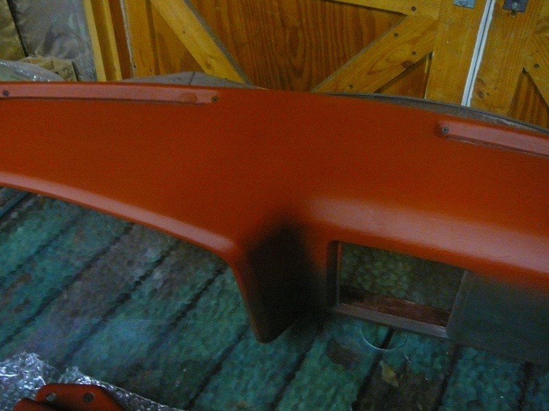

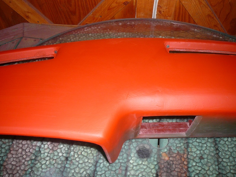

The dash top repair (several large cracks & speaker holes filled):
Not "Perfect" but for what I have planned, doesn't have to be
