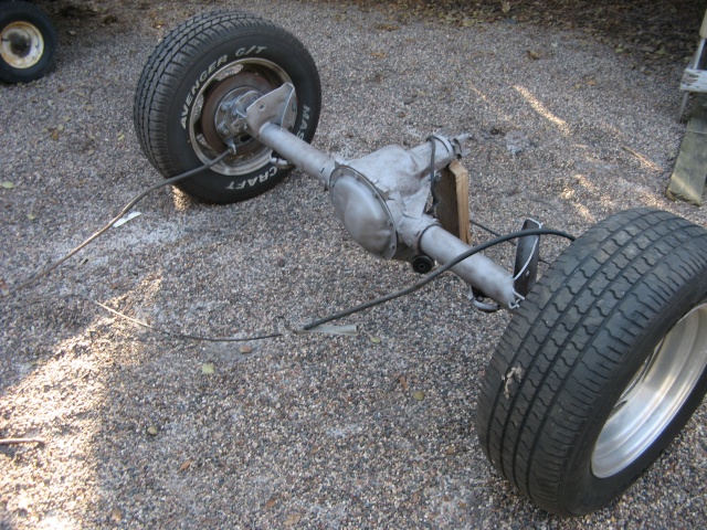

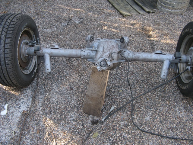

Post by Wallyuph Sat Dec 29, 2012 1:00 pm
I have a 1995 impala rear end in the 1974 I just bught. Here its is as I was sand blasting it. It was in the car with only shock bolts and two lower controll arm bolts no nuts.
Its up in now. The bolt pattern is 5 on 5 and he took the front controll arms and all off the impala also so at least all four wheel will be the same for me. I don't know if its wider or not just know it fits.
[img]rear end Img_6410[/img]
[img]rear end Img_6411[/img]

Post by driveit Sat Apr 06, 2013 7:47 am
Wallyuph wrote:I have a 1995 impala rear end in the 1974 I just bught. Here its is as I was sand blasting it. It was in the car with only shock bolts and two lower controll arm bolts no nuts.
Just wondering if you had to change anything at all on that swap. If I made a similar swap would I use the control arms from my 74 or from the donor car?
rear end Empty Re: rear end
Post by Wallyuph Sat Apr 06, 2013 7:56 am
I meant the front control arms/spindals. He used the rear ones from the 74. I did not do the swap my self is was sitting in there with only 4 bolts no nuts. I removed and replaced it after sandblasting and painting it. There was another post on here about doing a swap. To my knowledge its a bolt in swap. for the impala rear end. All though the bolt pattern for wheels is 5on5 so you will need to address that.
